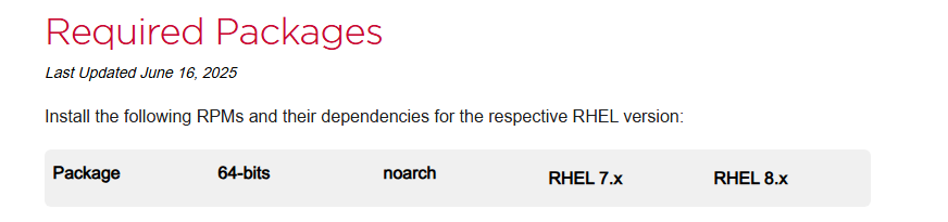

  • 4.  RE: About the problem after upgrading from 22.2.6 to 24.3.9
    Posted Jun 18, 2025 09:35 PM
    HI Jeffrey-san,
    In additional question.
    The TechDoc which you mentioned is not posted for RedHat 9.X.
    My customer's environment is RedHat Linux9.5.
    Best regrads,
    Marubun

  • 6.  RE: About the problem after upgrading from 22.2.6 to 24.3.9
    Broadcom Employee
    Posted Jun 19, 2025 10:34 AM
    So the link you provided is for new install and the link I provided is for upgrades.
    The upgrade page does have 9.x column for RHE9 packages needed which seems to align to the new install required packages.
    Yes, use EPEL package for RHE9.
