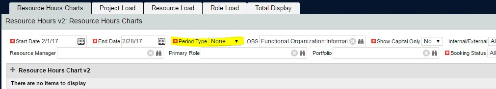

We have a big Page Filter portlet that loads slow! Is there a workaround, so it doesn't auto-populate records until we hit filter?  When I do it, the filter doesn't work unless I go to the portlet manually, and click on the filter first.
Answer
The easiest workaround is to force one of the defaults to an invalid value, to not show data. We changed the slice Period Type to "None" which results in the query not returning data. It forces the user to update the filter, if they want to use it, and greatly speeds up the overall page load times.
