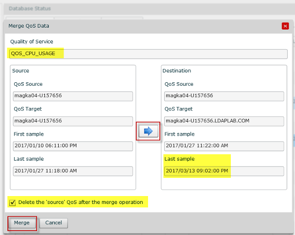

- UIM doesn't support merging data/rows for different QoS types. They must be the same.

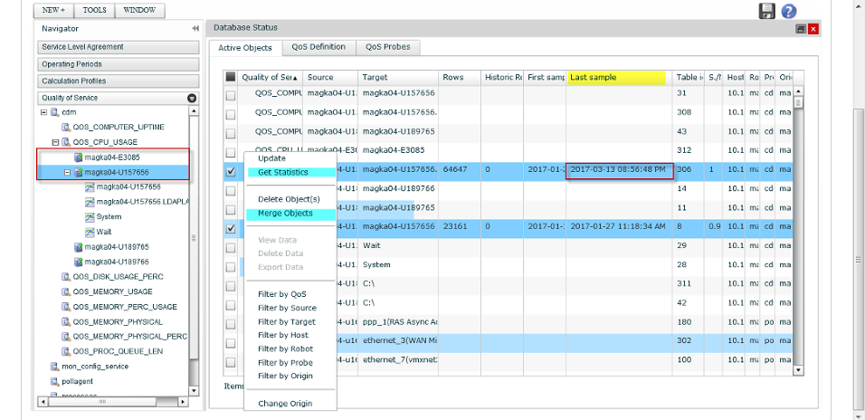

 - You can check the QOS data first that you are considering merging by hovering in the QoS column and selecting the black arrow and choosing Get Statistics while you have the QoS rows selected via the checkbox as shown above.
As an example, in the SLM portlet in UMP under Tools->Database Status, is the QoS data for a given QOS object such as QOS_CPU_USAGE_PERC, listed for both the short hostname and FQDN/longname?
If so, select the entries and use the drop down box (black arrow) to Get Statistics and see which QoS has the most current data (Last sample)
If one of the entries shows current data and the other one doesn't you can either delete the old QoS, or MERGE it in the direction to where it is currently being saved so then it will all show up in your reports/charts once merged.
Differences between QOS saved under a short vs long name source or even different targets, can affect its ability to be properly displayed in UMP/USM.
