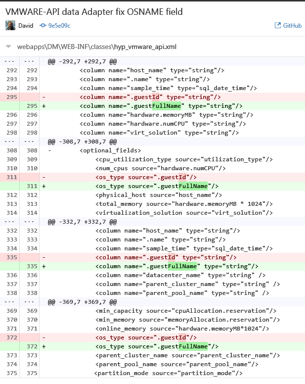

UPDATE: 2017-10-26
I was informed that this updated VMWARE-API data adapter has a problem, it reports the OS-TYPE of the GUEST incorrectly.
To correct this problem there are 4 lines in the XML file that need to be adjusted.
--- Backup the original XML file first. ----
Then adjust these lines documented below:  (Red - lines removed, Green - lines added)
Changes to make in XML file.
Contact support to get the fixes mentioned... maybe they will provide these four edits as well,
