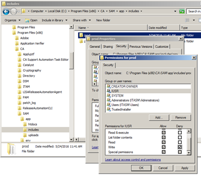

3. Give Write permissions to the IUSR on the htdocs folder
a.    Navigate to the app folder, e.g.  C:\Program Files (x86)\CA\SAM\app
            b. Right click on the htdocs folder and ensure that IUSR (IIS_IUSRS) (Or the user configured as IIS server user) has write access, in this case a Deny                policy has been added to protect the folders.
               c. Remove or add the Write permission and refresh the WEB page.

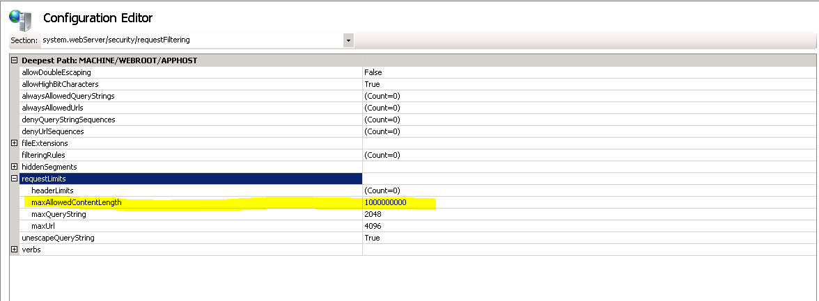

Verify/Modify MaxAllowedContentLength = 1000000000

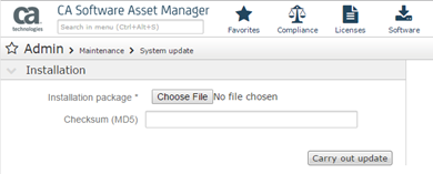

Admin-> Maintenance -> System Update
  1. Download the ZIP file from : http://www.ca.com/us/support/ca-support-online/product-content/recommended-reading/technical-document-index/ca-software-asset-manager-solutions-catalogs-index.aspx
    b. Place the file so it can be browsed from the Browser.
    c. Press ‘Choose File’ and select the ZIP file
     d. Select ‘Carry out update’
     e. Click ‘Ok’ to start the system update

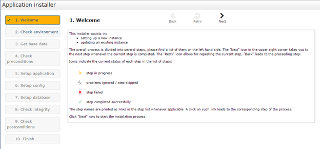

     You will first see that the ZIP file is uploaded
     The install will start

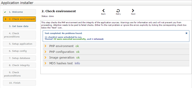

     f. Press ‘Next’
          g. Verify that all is good, if you see errors try to correct them and retry
          h. Press ‘Next’
          i. Verify data and press ‘Next’

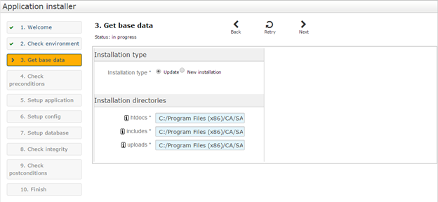

     l. This is a screen just to ensure that the Pre install conditions are met.    If you are sure the prerequisites are met,   press ‘Skip step’ or check the 3 check boxes      and press ‘Next’
               This is a drive space check.

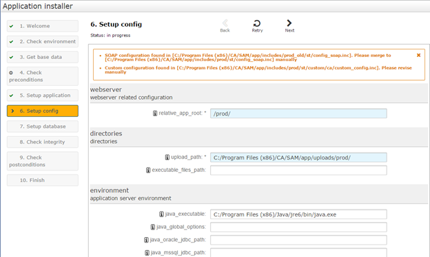

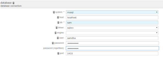

     n. Once the copy is done you need verify the configuration. You should not need to change anything as this is an upgrade, but verify the database password is           populated
          Note:  This is important information as the config_soap.ini and the custom_config.ini, we use this information in the post update tasks.

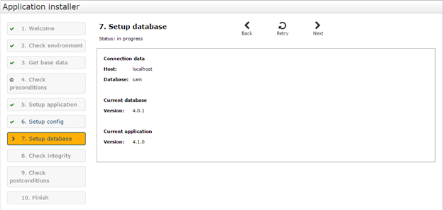

          The Setup will look at the database version and update it if needed. In this case it is needed.
          p. Press ‘Next’

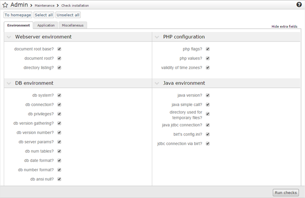

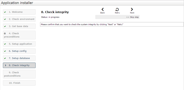

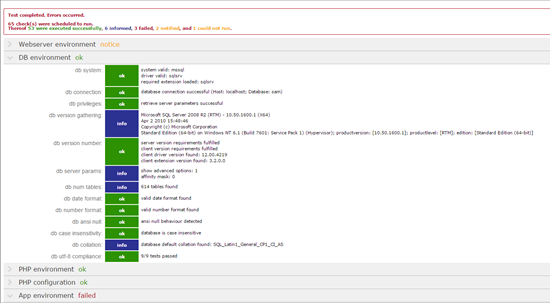

     q. Run a System check or Skip the step. You can run the System Check afterwards if you like from Admin -> Maintenance -> Check Installations
     r. Press ‘Next’ to test
Note: The test can take a couple of minutes.

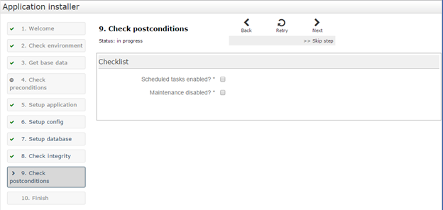

     s. Similar to step l above, this is just a maintenance check list. It can be skipped or check all boxes and press ‘Next’.
     t.  If you leave the Cleanup install checked it will remove the ZIP files from the install but not the {tag}OLD folders created during the install.  It is recommended to           check the box and clean up the Installation.

          v. click ‘Run Checks’ to verify the installation.
               The check can take some time (5-10 minutes). And it will present you with a status like this:

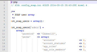

b.  Update the config_soap.ini
As noted in the installation you need to check the SOAP configuration. By default SOAP is disabled.
  • Open the config_soap.inc file at the following location:
Program Files (x86)\CA\<tag>\includes\prod\st
  • Copy the login and password from the  old config_soap.ini at includes_old\st\config_soap.ini folder into the new config_soap.inc folder
  • Remove the comments on  line 8 and on line 170
