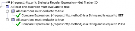

Next, let’s isolate the resource id from the URI and save this as a context variable named ‘trackerid’. We can use a simple regex assertion to accomplish this. Also, I will branch on the incoming HTTP verb using an OR statement. I am just focusing on GET and POST for this example but you could add additional logic for other HTTP verbs that you want to support for this REST service.
Regex for REST service resource identification
Policy branching for GET vs POST

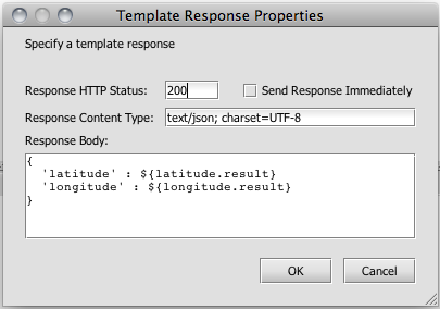

The REST response is then constructed back using a template response.
Template JSON response
