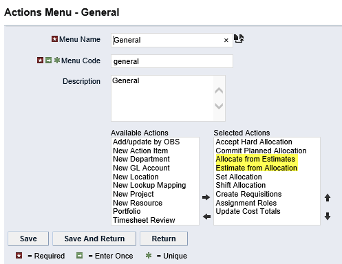

The Team tab has an action that allows you to update ETC, based on a change in the allocation percent (found in the resource properties from the team tab). This action is called Estimate from Allocation. It appears to be missing from the 14.2 Team tab Actions menu:
I double-checked the Actions Menu to make sure it's selected:
Then I found a knowledge base article on this issue that indicates the system is down for maintenance:
https://support.ca.com/irj/portal/kbtech?docid=531157
Being impatient, I’m wondering if anyone has found a way to put Estimate from Allocation back on the Team tab Actions menu.
Answer 1
This action will only show up on projects which have a single effort task (~rmw). If the project has a complete WBS structure with many task assignments, this job will not be available as the job would not know how to perform the split.
Answer 2
I believe this is usually a link to the Job: Update Estimates from Allocation, which requires that the project/NPIO, have an Effort task – id  = ~rmw.
If there is no effort task on the Project, I think this won’t display in the list.  It would make sense, since you normally, on NPIOs, don’t get to see the Task tab and therefore can’t set the ETCs directly.
You can test that out.  I may very well be wrong. ;-)
