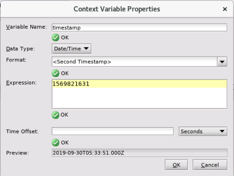

    Hello All,
    Currently we are getting iat in seconds from okta. Trying to validate the iat with current gateway date. Could you help me how to convert the Example:1569821631 to 09/30/2019 and compare with current gate ${gateway.time.MM/dd/yyyy}.

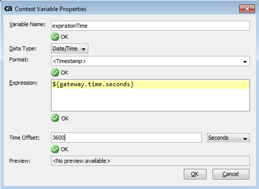

    For Expiration exp I'm currently comparing ${gateway.time.seconds}. Is there any option to perform
    Validate Expiration claim (exp) against current date + n? minute clock skew
    Regards,
    Prem.

    Dear Prem,
    You can use set context variable to convert the timestamp, for example,
    timestamp
    Then when you access ${timestamp}, you will get the value as "2019-09-30T05:33:51.000Z"

  • 3.  RE: Re: JWT iat and exp validation
    Posted Oct 02, 2019 12:39 PM
    Thanks Mark!
    That works.

    Hi Mark,
    Is there any option to perform below validation
    Regards,
    Prem.

    ​Prem,
    In the JWT generation we define the exp value as the result of curr_time + n (seconds), through "set context variable" below. In the final of this process you will have the variable expirationTime with calculated value. See image below
    exp
    I hope to help,
    Best Regards,
    Porcel

    Posted Oct 16, 2019 03:11 PM
    Thanks Porcel!
