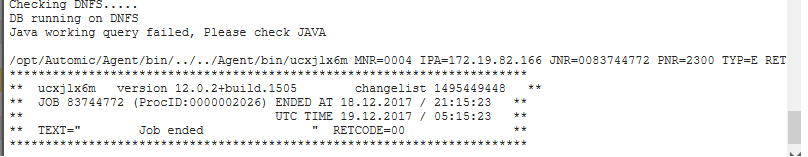

    When I run the Job, it's getting to this place in the code and exiting, but not failing.
    awos96ulnqn5.pnghttps://us.v-cdn.net/5019921/uploads/editor/8p/awos96ulnqn5.png" width="808">

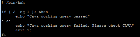

    I have done a little test myself with a simple unix Job I created with only this code
    7mm4qhcic2ia.pnghttps://us.v-cdn.net/5019921/uploads/editor/7a/7mm4qhcic2ia.png" width="482">

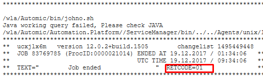

    When I called from Automic, it behaved as I expected, job failed.
    mm666odreb7o.pnghttps://us.v-cdn.net/5019921/uploads/editor/sd/mm666odreb7o.png" width="520">
