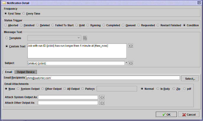

Below I set up a similar configuration and it works for me:
The condition
The details

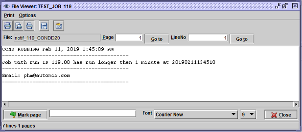

I set this condition to a Job that runs longer then 2 minutes and you can see the notification being sent in the output tab

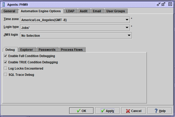

If you are not seeing the notification in the output tab, it was not sent or the evaluation never too place either due to an error or because the Job took longer than 1 minute but finished faster then the next condition evaluation time. You can enable server/rmi debug and enable condition debugging to easily see if condition evaluation is occurring.
Condition debug can be enabled in the Automation Engine Options (edit master's local agent)
After enabling condition debugging and allowing the Job to run and finish, you can review the RmiServer<timestamp>.log and you will see condition evaluation similar to below:
