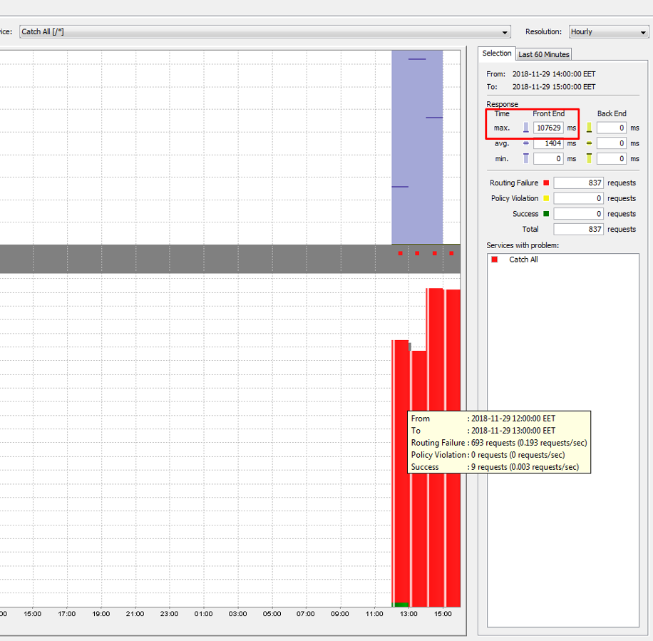

    Dear Community,
    We have two clusters which are load balanced externally via f5.
    Gateway Version : 9.1
    From our customers, I am sometimes getting that our services are not responding-unreachable.
    When I inspect the dashboard during blackouts, in some cases I can realize that incoming requests are decreasing(for all services) for a period of time. (I am assuming this might be a network problem)
    (for ex: in the day time we are receiving around 200 req/sec, however during these blackouts we get around 3-5 req/sec)

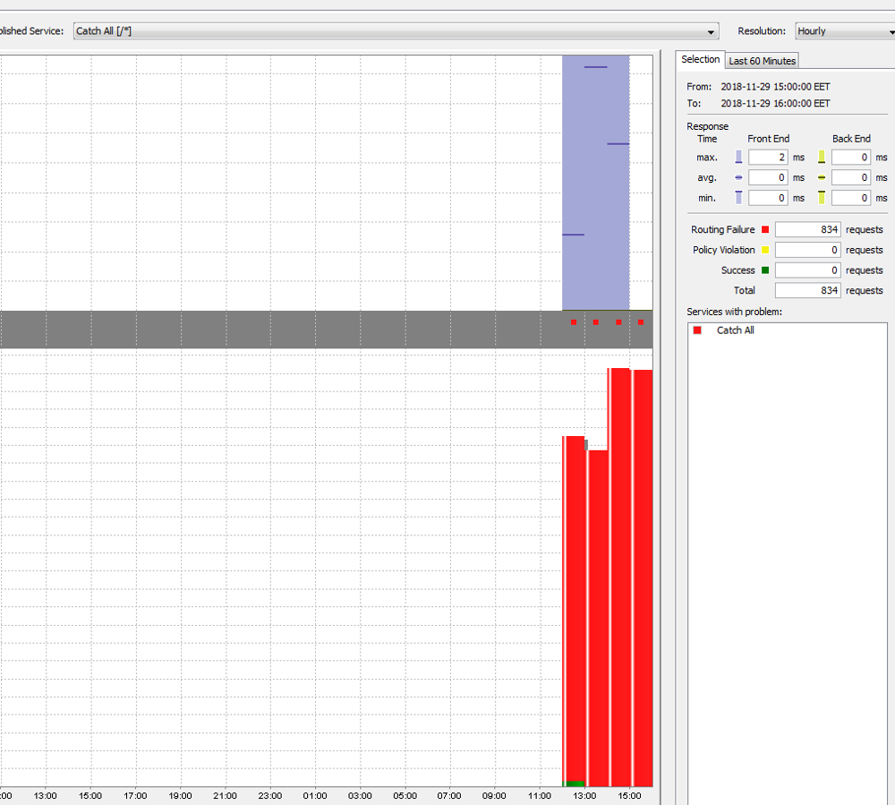

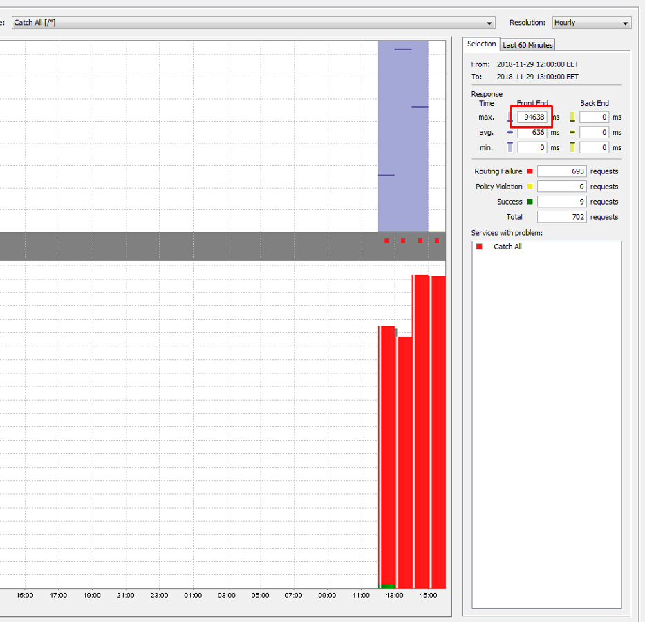

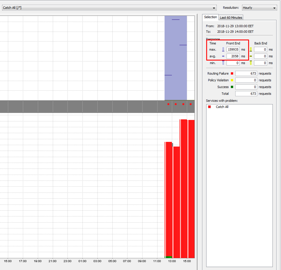

    I implemented the cath all policy for changing the default service not found response , as users have mentioned in the community.
    However when I inspect the dashboard, I am seeing some weird response times from gateway(front end).
    Would this be relevant to blackouts that I am getting?
    I will show you maximum front end reponse times for the catch all policy with screenshots.
    Any ideas or direction will be greatly appreciated.
    Warm Regards.

    What is your catchall policy doing that it is having routing failures?
  • 3.  Re:  High Front End Response Times
    Posted 11-30-2018 01:39 AM
    Dear Barry,
    The policy is just returning a template response.
    It's just a lightweight xml message, there is no policy logic inside.
