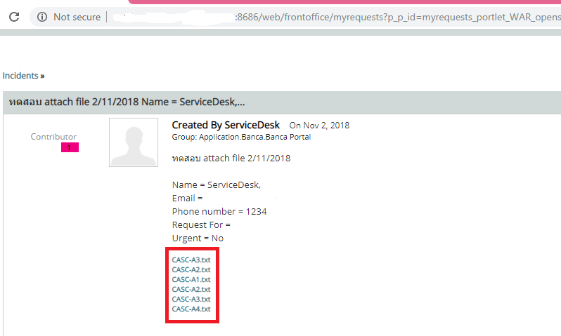

    When I create new Report and Issue on USS and I attach more files. After I click submit button and open my request that I  found files duplicate.
    1. I create new Report and Issue and attach files name ("A1.txt,A2.txt,A3.txt,A4.txt") but It duplicate files name ("A2.txt,A3.txt"). You see below picture.
    CA USS Web Screen

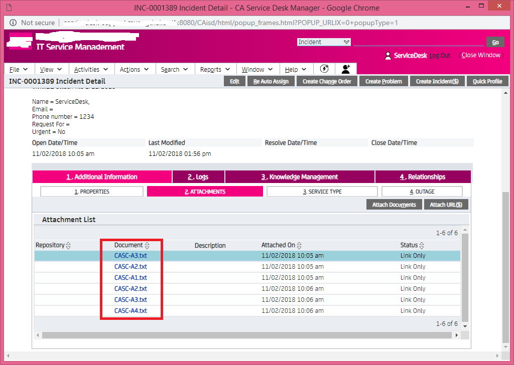

    2. I open Service Desk and I found duplicate files name ("A2.txt,A3.txt"). You see below picture.
    CA Service Desk Screen
    What shall I do,Please help me.

    OK, in my 17.1.01 tests, it looked fine.  One USS -> Catalog request,  3 attachments  showed up as 3 attachments in SDM (as hyperlinks to Catalog of course).

    I performed a quick local 17.1.RU1(+patches) test.
    In USS-UI,
    - hit 'report an issue',
    - add comment+attachment+post 3 times
    - hit Submit
    >1 no request creation conformation-popup appears
    >2 the SC-request gets created though
    >3 the linked/corresponding SDM-incident gets created too
    >3 no attachments at all visible in both the SC-request as well *** the SDM-incident.
    On a local 14.1 environment all works okay.
    Perhaps it is best, you open a standard case for full analysis and follow-up?
