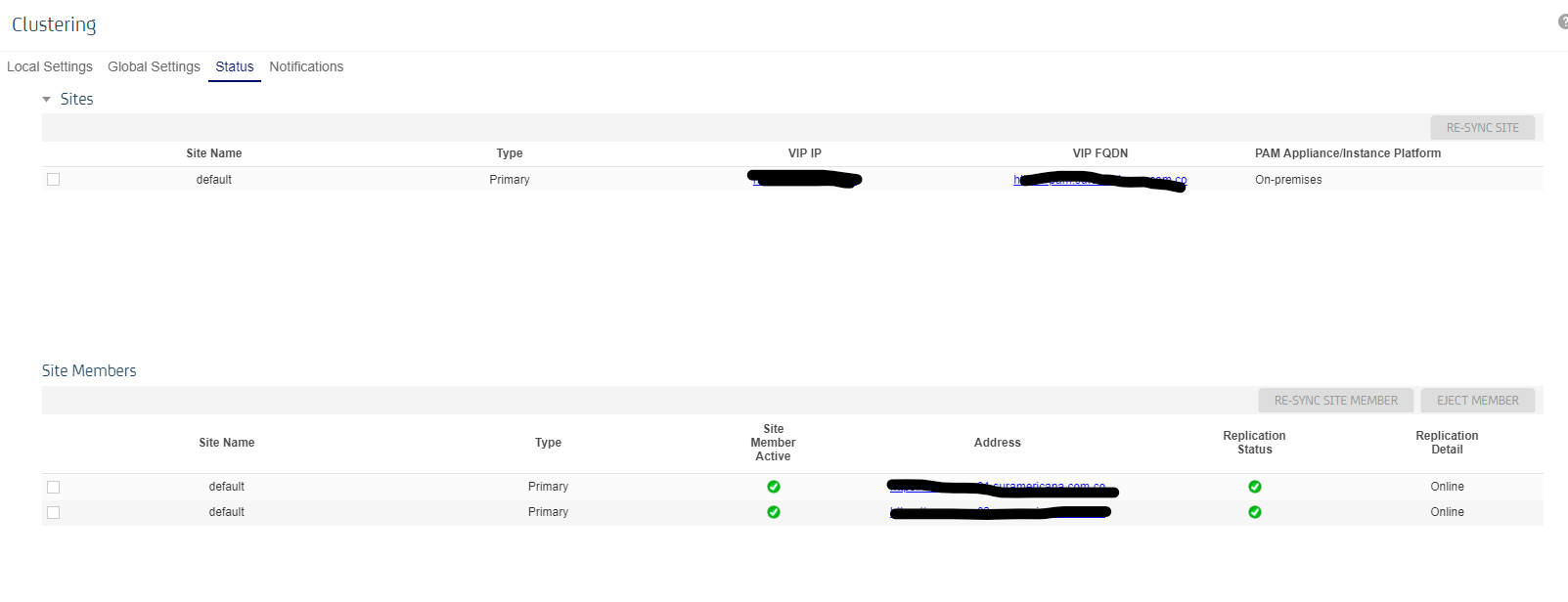

    In this moment, we have a open case about this issue 3 weeks ago, we do not have a satisfactory answer yet and the issue persist and the customer (Core account) complain about that. Please can you tell me where can i setting next: "As a work around, CA technologies Techinician has change the next parameter : Configuration/Clustering/tuning/Max number of...from 10000 to 20000"
    In the image below do not appear that route "Configuration/Clustering/tuning/Max number" where i can found it.
    Yesterday we upgrade to version 3.3 and the message persist.
    Thank for you help.

    Hi Adolfo, Cluster tuning parameters, and how to make them visible in the UI, are discussed in our online documentation, see https://techdocs.broadcom.com/content/broadcom/techdocs/us/en/ca-enterprise-software/layer7-privileged-access-management/privileged-access-manager/3-3/deploying/set-up-a-cluster/configure-a-cluster.html#concept.dita_30f62b5da45eda51a0c59e3b30699fbe1d7588aa_ClusterTuningClusterTuning
  • 9.  RE: Re: Clustering keeps getting out-of-sync
    Broadcom Employee
    Posted Sep 27, 2019 03:25 PM
    ​I received a reply from Adolfo, but don't see it here. It's stating that changing the configuration setting doesn't eliminate messages like
    WARNING:PAM-CM-0451: ServerReachabilityMonitor.run Server '10.xx.xx.xx' reachability changed: 443=<removed> (filtered), 3307=<removed> (filtered), 5900=<removed> (filtered), 7900=<removed> (filtered), 7901=<removed> (filtered)
    Such messages would not be affected by any tuning parameters. They come from a watchdog that periodically checks connections to other cluster nodes in the same site for the ports involved in cluster synchronization. None of the cluster tuning parameters are of any interest to that watchdog. They also are not concerned with the actual synchronization of data. As long as the databases keep showing active on the cluster status pages there is no real problem with the synchronization.
