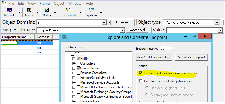

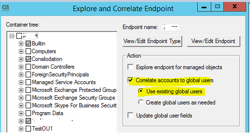

    1. Provisioning Manager   --> End Points --> Created New End Point  --> First Ran Explore End Point  then Correlate End Point using "Use Existing Global user".
    2. I can see all the user who are Migrated from XYZ to ABC.

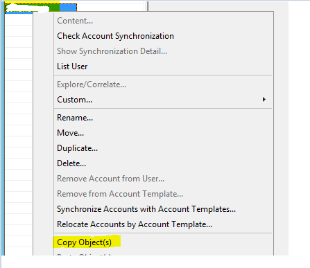

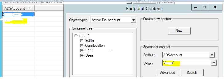

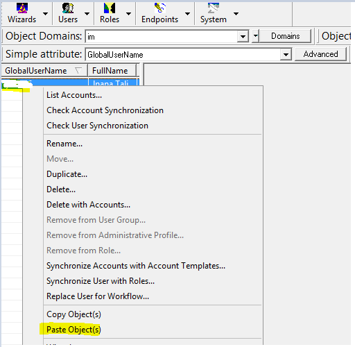

    3. I  have searched user on ABC End Point --> Copy Objects --> Paste objects on the Global user.
    4. When I checked Lisrt accounts it showing account also.
    5. Assigned the Provisioning Role using CA Identity manager console and then I have searched user on and am able to see the details on Global user and able to List the account same like above.

    If I understand correctly you have two AD endpoints (XYZ and ABC). You should be running an Explore on both of the endpoints. The Explore would see the account no longer exists on XYZ endpoint and so the account reference object and the inclusion object linking that account to the Provisioning user would also be removed. The Explore of the ABC endpoint would find the account and a Correlate of the ABC endpoint should link the account to the Provisioning user assuming the correlation criteria finds a single match.

    Thanks for providing comments. It worked. Now I am able to link all the users Using Explore / Correlate.
