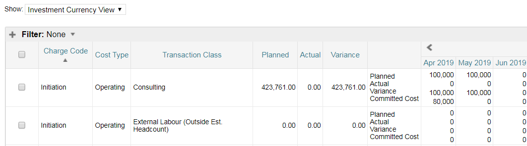

    I have created a time-varying attribute in the Cost Plan detail object to capture the committed costs of the project on a monthly basis. I have marked that attribute to include in DWH and executed full load data warehouse job. I want to include that as part of domain and use in ad-hoc reporting. I am trying to figure out which DWH table holds this information?
    Screenshot: the way I am planning to capture commitments in cost plans:
    Regards
    Praneeth

    Praneeth,
    I believe it goes into dwh_costplan_facts
    You can check by querying
     select * from dwh_meta_columns  where src_column_name = '<enter the ID of the attribute'>
