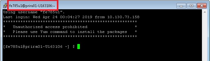

    Hello Harshitha, I am a bit confused about your question. You say that the PuTTY windows display the host name instead of the IP, which commonly would be regarded the preferred method since it is easier to recognize hosts by name rather than IP. I suspect your problem is that you don't have the target device name in the PuTTY sessions launched from PAM, but the local IP to which PAM makes the PuTTY client connect. If that is your problem, you should update the Client Application string in the TCP/UDP service you have defined in PAM. I use the following string:
    "C:\Program Files (x86)\PuTTY\putty.exe" -ssh <user>@<Local IP> <First Port> -loghost <Device Name>
    The "-loghost <Device Name>" argument results in the target device name being shown in the PuTTY Windows title:

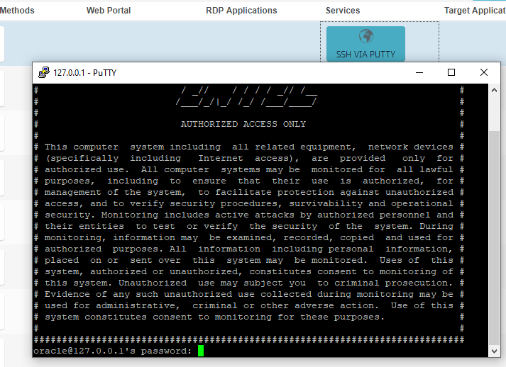

    Thank you for your help, I have configured for auto login with an ssh key but when I configure the service to be via putty I ask user and pass .. I attached a video for more details

    Hi Jorge, Your video does not answer my question. It only shows that target accounts were configured for auto-login for the SSH applet. It doesn't show whether you configured the PuTTY service with a target account for auto-login. I think the answer must be NO because when we see the password prompt, we can see that the user name is "<user>". This would have been translated by PAM into the name of the target account, if one had been configured.

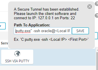

    modify the Putty configuration by setting the user oracle, now it shows the user but keep requesting the pass again
    "C:\Program Files (x86)\PuTTY\putty.exe" -ssh oracle@<Local IP> <First Port> -loghost <Device Name>

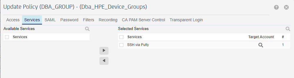

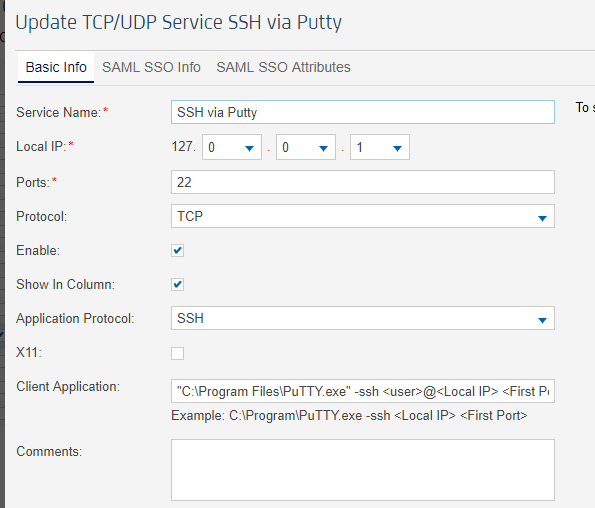

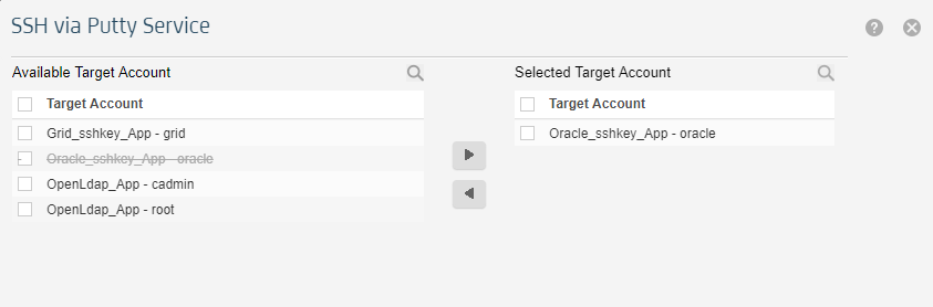

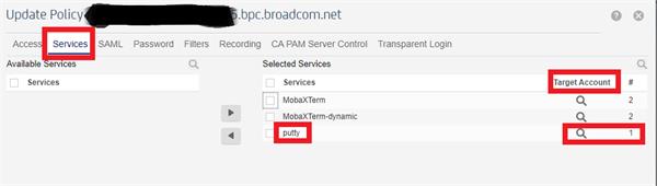

    Jorge, That is totally wrong. You are modifying the Client Application string, which is part of the TCP/UDP service definition. I am asking you about your policy configuration. That's where you have to add the target account. In the application string you have to keep using the <user> token, otherwise the service will always try to login with the same account name, no matter which host you connect to.

    I have made the changes but I am doing something wrong, this is my configuration
    TCP/UDP Service
    "C:\Program Files\PuTTY.exe" -ssh <user>@<Local IP> <First Port>
    Policy
    SSH PUTTY

    Hi Jorge, You have to get rid of you local Client Application string where you entered user "oracle" and overwrote whatever string you have defined in the TCP/UDP service. Launch the service, go to the popup showing the local IP and your custom Client Application string, remove your own string from there (make sure the field is completely empty), save and then launch the service again.

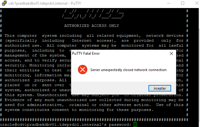

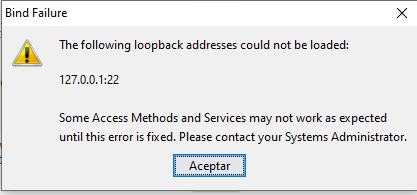

    I have made all the configurations without obtaining results, it is possible that you can connect to my PC to see what is wrong, or send a small step-by-step instruction, we really need to use it
    I have these error messages every time we use this service
    Help me please its` stucked

  • 12.  RE: Re: Need IP address on putty screen name
    Best Answer
    Broadcom Employee
    Posted Nov 14, 2019 11:34 AM
    Hi Jorge, You get this message if you start a second client instance, and the first one is listening on this local IP and port already. Make sure you have only one CAPAMClient.exe process running. If you need further assistance, please open a support case. However, all the information needed to get this going was provided already, and you should be able to get this going. TCP services using SSH clients like PuTTY and auto-login are very widely used with PAM, and they work!
