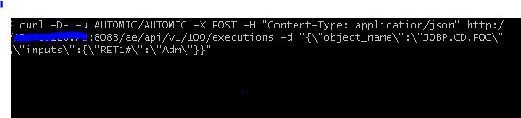

  • 9.  How to make AE REST API call using Curl command
    Posted Mar 19, 2018 02:38 PM
    Thanks heiei01  :)
    I tried that but it didn't work for me. It is showing no output and must be expecting some more characters I guess.
    sxwwq143s97a.jpghttps://us.v-cdn.net/5019921/uploads/editor/s7/sxwwq143s97a.jpg" width="587">
    Regards,
    Srujan.
  • 10.  How to make AE REST API call using Curl command
    Posted Mar 21, 2018 06:12 AM
    Hi,
    100 in the url must be replaced by your clients nr. Like this
    http://<hostname>:8088/ae/api/v1/<client>/executions
    Matthias

  • 12.  How to make AE REST API call using Curl command
    Posted Mar 21, 2018 08:45 AM
    Upps, yeah sorry. Haven't seen its on your screenshot.
    Did you get any error message?
    Did you try without the "inputs"?
    Is there anything listening on port 8088 of your host?
    Use
    telnet <host> 8088
    or on the destination host
    netstat -lenp | grep 8088
    to check.
