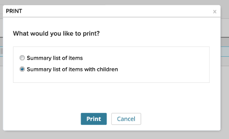

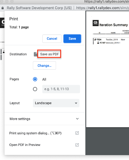

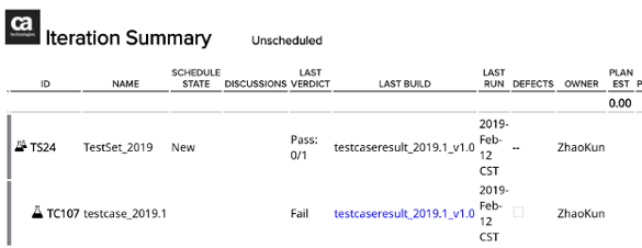

    Hi BernadetteRobinson1349894
    So how about Print option? After you click the print button, then you could select "Summary list of items with children".
    Then click "Print", from the print summary page, you could select save as PDF.
    Then I think you could see the result you want.
