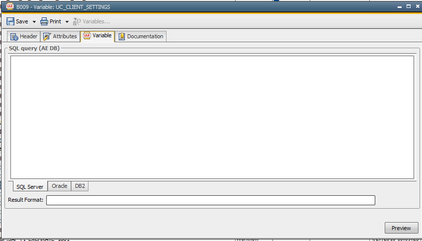

    As I read the document, we need to configure email connection to send mail, we have to configure UC_CLIENT_SETTINGS.
    https://docs.automic.com/documentation/webhelp/english/ARA/12.0/DOCU/12.0/ARA%20Guides/Content/AWA/Installation/install_mail_connection.htm
    But in my case, no setting in UC_CLIENT_SETTINGS, but I still receive the email.
    kleb5hl49edo.pnghttps://us.v-cdn.net/5019921/uploads/editor/2u/kleb5hl49edo.png" width="853">
    Could you please advise me.

    And you are sure you are logged in client 0?
  • 3.  UC4 email connection
    Posted Aug 25, 2017 06:54 AM
    Robin_Markwitz_6324,
    Yes, I logged in client 0.

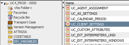

  • 4.  UC4 email connection
    Posted Aug 25, 2017 06:56 AM

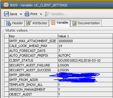

    Here is the screenshot

    As I check on my client (not client 0), it doesn't have settings in UC_CLIENT_SETTINGS too :(

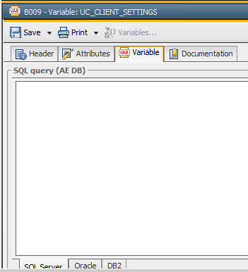

    In my client setting (not client 0) nothing can help.
    16hgntyrnqbv.pnghttps://us.v-cdn.net/5019921/uploads/editor/oa/16hgntyrnqbv.png" width="849">

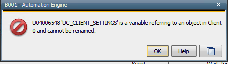

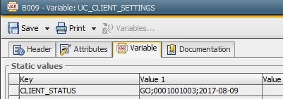

    I think I found one part of the error:
    Your screenshot above is NOT showing a UC_CLIENT_SETTINGS VARA because this in the screenshot is a SQL VARA but UC_CLIENT_SETTINGS is a static VARA object....
    possibly renamed?
    per default an UC_CLIENT_SETTINGS VARA looks like this:

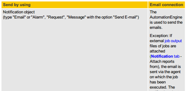

    Here is a part of the document. Does it mean AE itself a local MTA?0aff1p8l8thg.pnghttps://us.v-cdn.net/5019921/uploads/editor/cx/0aff1p8l8thg.png" width="609">. I
  • 16.  UC4 email connection
    Posted Aug 28, 2017 06:32 AM
    Nope, AE is not an MTA.
    MTA: Mail Transfer Agent, such as Sendmail, Exim, Postfix, Qmail. Mostly a UNIX term.
    AE just generates emails and sends them (much like an Email client) via classic, unencrypted port 25 of an email server. It does NOT incorporate it's own email server (or for that matter, MTA).

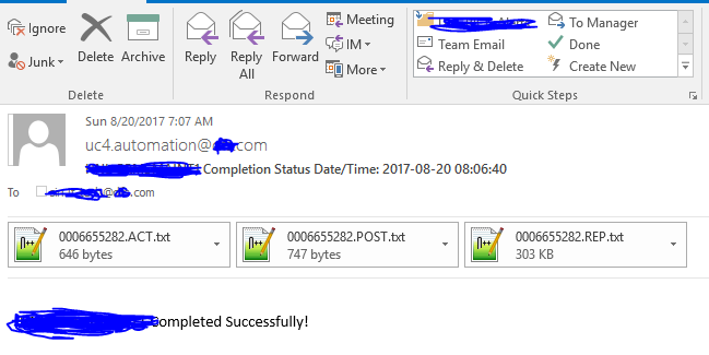

    Posted Aug 31, 2017 04:46 AM
    Carsten_Schmitz_7883 MatthiasSchelp

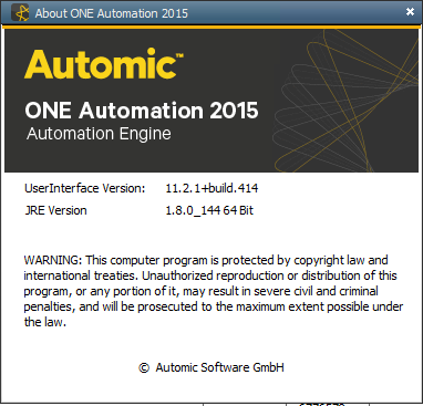

    My AE version is here:
    zqv25wd7xjx0.pnghttps://us.v-cdn.net/5019921/uploads/editor/wi/zqv25wd7xjx0.png" width="382">
    Here is the email I received
    My AE is also the agent for itself too.
    Here is the mail header including the info from sender

    By the looks of the mail itself, has an activation report, a report and some sort of output attached. That means it's (at least according to the documentation) very likely being sent by the agent, not by the engine. Now I thought that the agent has it's own SMTP configuration (eventhough I could not find anything about it in the documentation), so that would have explained why you get these mails without an engine SMTP config.

    One more lead though: All the attachments have "6655282" as part of the file name. That's probably the RunID. You can look up the RunID, that will show you the job that generated this email. Then you can find conclusively how it was sent (probably a call object). Once you found it, and if you really have no SMTP configuration in the engine in any client, I suggest you open a ticket with Automic and include all the information gathered thus far. Because that would, imho, mean that either their documentation is wrong or there is something truly unexplained going on.

    Just FYI - the mail in the screenshot indicates that it was sent by a Notification object and has added Activation-, Post Process and Job Report using "Add Reports from Task" within the CALL object.
    https://docs.automic.com/documentation/WEBHELP/English/AWA/11.2/AE/11.2/All%20Guides/help.htm#ucacox.htm%3FTocPath%3DUser%2520Guide%7CObjects%7CAlphabetical%2520Listing%7CNotification%7C_____6

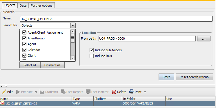

    I personally would try searching for the SMTP settings within AE Client 0 AND your Client - without these settings the AE is not able to send emails.
    AS I suggested some posts ago, search for the correct (!) UC_CLIENT_SETTINGS VARA object.

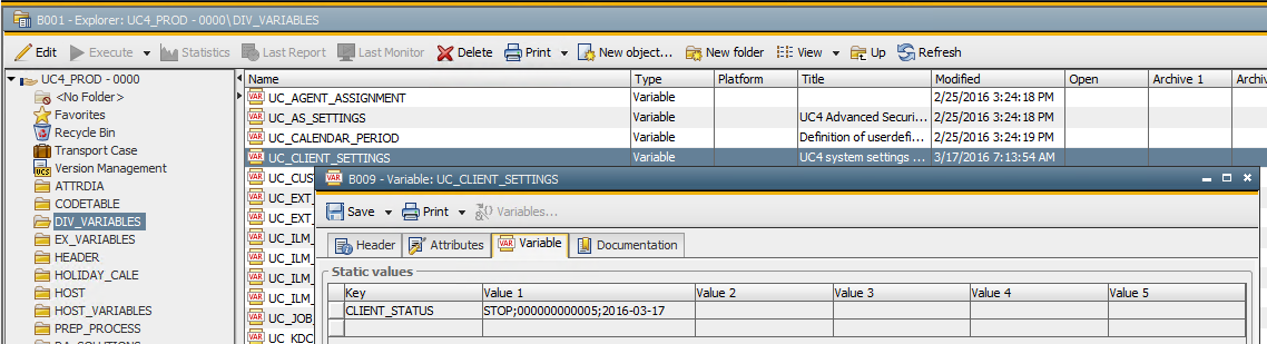

  • 23.  UC4 email connection
    Posted Aug 31, 2017 06:44 AM

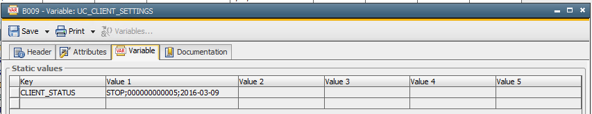

    FrankMuffke
    Here is what I found in the client0
    1a7gujatn60n.pnghttps://us.v-cdn.net/5019921/uploads/editor/o3/1a7gujatn60n.png" width="1138">
    Yes, we have postprocess, notification, and variable

    s8yj5mr7lizi.pnghttps://us.v-cdn.net/5019921/uploads/editor/v2/s8yj5mr7lizi.png" width="745">
    FrankMuffke
    That's what I search for UC_CLIENT_SETTINGS. Is it correct what you recommend?
  • 33.  UC4 email connection
    Posted Sep 01, 2017 06:28 AM
    Can you please help share with the screenshot of correct UC_CLIENT_SETTINGS VARA?
  • 34.  UC4 email connection
    Posted Sep 04, 2017 08:28 AM
    Hello,
    On my test system, I found the UC_CLIENT_SETTINGS in "No Folder"
    jjj1ul7rmnan.pnghttps://us.v-cdn.net/5019921/uploads/editor/0t/jjj1ul7rmnan.png" width="372">
    But on my production system also in "No Folder", it looks like this:
    So, confusing me with my Prod :(
  • 35.  UC4 email connection
    Posted Sep 04, 2017 08:32 AM
    As Wolfgang already speculated, you appear to have an SQL-type variable called "UC_CLIENT_SETTINGS" in your production system. This is wrong, probably someone tried to create the variable from scratch and chose the wrong variable type. Since you can't have two objects of the same name (per client, not only per folder), this means you can't ever have a UC_CLIENT_SETTINGS of the correct type unless the SQL variable is removed.
    This should be fixed in your system.
    Whether it has any relations to the unexpected receiving of emails, I can not tell (I suspect not, but ...).

    Posted Sep 04, 2017 10:04 AM
    Phat Tran said:
    cannot rename it
    evbsttkjn25l.pnghttps://us.v-cdn.net/5019921/uploads/editor/wp/evbsttkjn25l.png" width="455">
    Hmmm ... I don't know, could be something I don't grasp, or could be a bug. I have separate UC_CLIENT_SETTINGS in my client 0 and my "proper" client as well, and I am getting the same message if I try to rename it in my "proper" client.
    Sorry. No idea. Unless someone else has an idea, might want to ask their support for help with cleaning up your SQL variable.

    That means the variable UC_CLIENT_SETTINGS was overwritten by a transport case. System variables in client 0 cannot be renamed. Export the variable from another client and import it into client 0. Then you can type in the appropriate values.

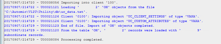

    Posted Sep 08, 2017 12:53 AM
    I misread it then, I thought it was in client 0, my bad. In this case you can unload it from client 0 (right click on it --> External & Printing --> Transport), use DB.UNLOAD which creates a file called uc_data.txt in the utility\db folder, use the DB.LOAD to load it in the client you want too. During the load you will be prompted to overwrite the variable, because it already exists in the other client. Just press 'Yes'.
    u2mtxgmhvz0o.pnghttps://us.v-cdn.net/5019921/uploads/editor/gh/u2mtxgmhvz0o.png" width="761">
    Ignore the second variable i had in my transport case (UC_CUSTOM_ATTRIBUTES).
