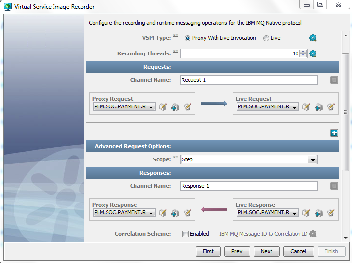

    I am trying to create VS with a requirement that : Once Virtual service is developed - it should give virtual response and if I change execution mode to Dynamic/Live, it should call Live service to give response. I have Req-res pairs available.
    If I decide to create VS through MQ Native protocol with live recording (VSM Type: Proxy with live recording), I guess i have to create open Proxy (Request & Response) Queue so that it can have channel connection with Live queues. As soon as I give Live queue details over there same gets populated fro Proxy. For Ex:
    Queue Manager: QUS1
    Live Request Queue: PLM.SOC.PAYMENT.REQUEST
    Live Response Queue: PLM.SOC.PAYMENT.RESPONSE

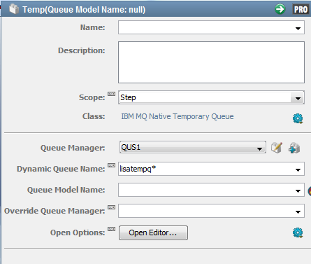

    What details should I give for Proxy Queue. Shall I have to create IBM Native Temporary Queue and If yes, what should we give as Queue Model Name. Or Do we need to ask MQ team to create Proxy queues for us to utilize.

  • 8.  Re: How to do MQ Service Virtualization - with Dynamic mode
    Broadcom Employee
    Posted Aug 01, 2018 08:56 AM
    Yes, you need to ask MQ team to create proxy queues for you. See also IBM MQ Native Transport Protocol - DevTest Solutions - 10.3 - CA Technologies Documentation for step-by-step instructions.
