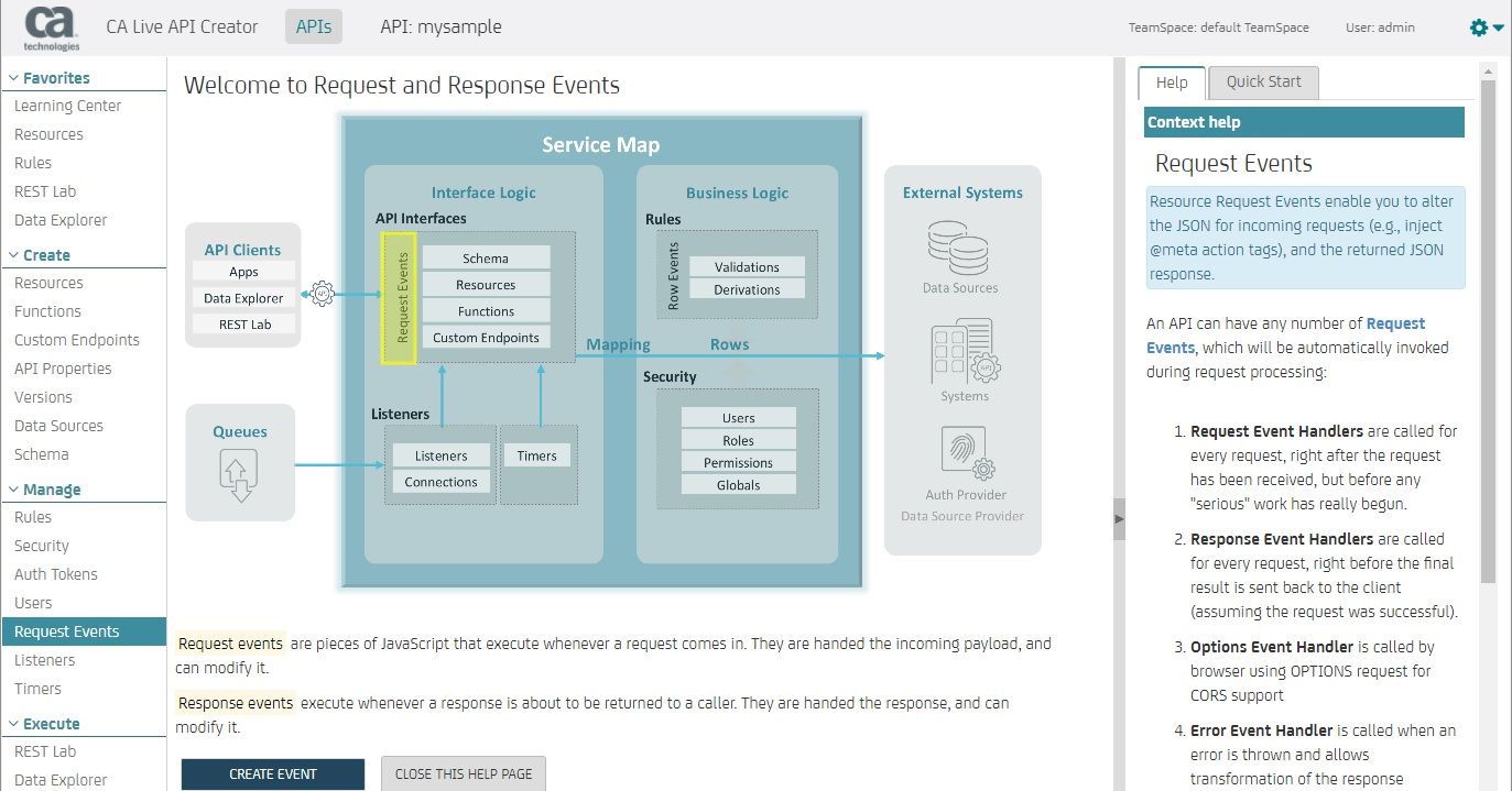

    It looks LAC can transform incoming HTTP requests by creating Request Event Handlers.
    https://docops.ca.com/ca-live-api-creator/4-1/en/developing-apis/extensibility/event-handlers/#EventHandlers-RequestEventHandlers
    The request body is set to a pre-defined variable "json" as raw JSON string.
    I checked the contents of "json" by setting "log.debug('json=' + json);" in an Event Handler and I found the "json" variable was set properly as a JSON string regardless of the request's Content-Type (either application/json or application/xml).
    LAC transforms request messages from XML to JSON automatically, so JSON to JSON transformation is necessary in the Event Handler before your resource endpoint.

    XML to JSON conversion is automatically done by LAC in the very early stage, so I think JSON to JSON transformation is necessary in a Request Event Handler (javascript code) of your resource endpoint.

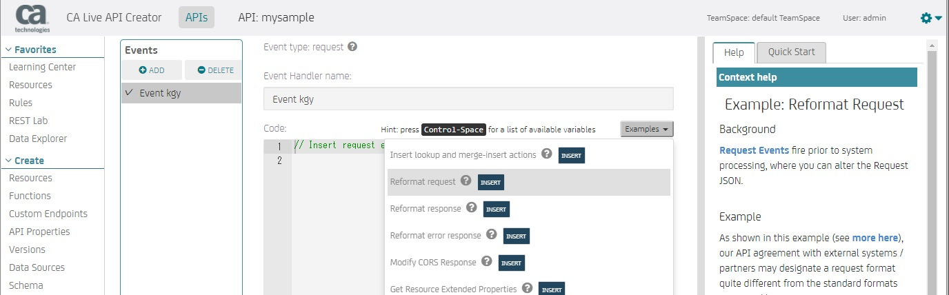

    Request Event Handlers work as "filters" for Resources and Functions, so it is enough to put the reformatted JSON string back to the "json" variable.
    I found an example about "Reformat Request" was included in the Web UI of LAC 5.0.
    Best regards,
    Seiji
