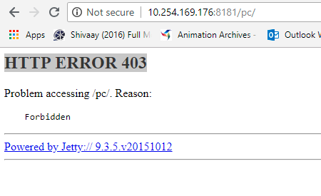

    HELLO,
    After installaction of CA Performance management now i am accessing the web view through URL: http://10.254.169.176:8181/pc  i enabled this port through network firewall and also disabled system firewall but its showing the following error.
    error shown while accessing PM url

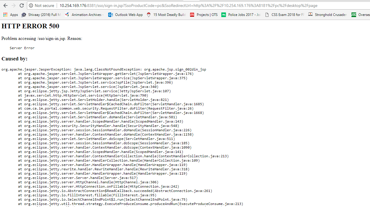

    when i access it through 10.254.169.176:8181  i will get the following error.
    please guide me about the solution of the problem.

    For the first part, going to this URL will not work:
    Go to the other URL instead:
    Now regarding the 500 server error, are the Performance Center processes running?
    mysql
    caperfcenter_eventmanager
    caperfcenter_sso
    caperfcenter_devicemanager
    caperfcenter_console
    If they are all running, restart the console as it may of finished starting before the Device Manager:
    RHEL6:
    service caperfcenter_console restart
    RHEL7:
    systemctl restart caperfcenter_console
