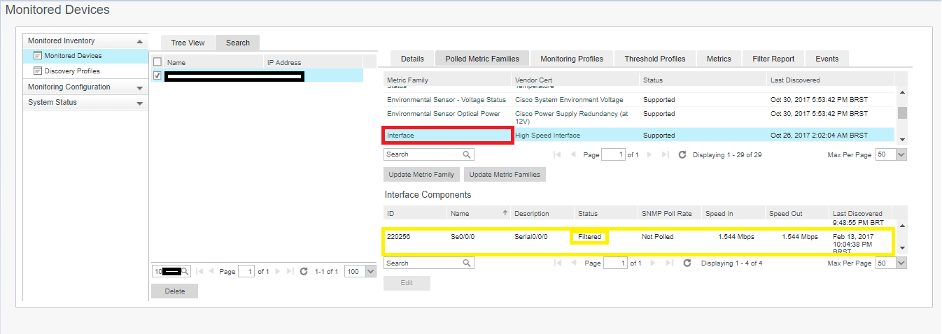

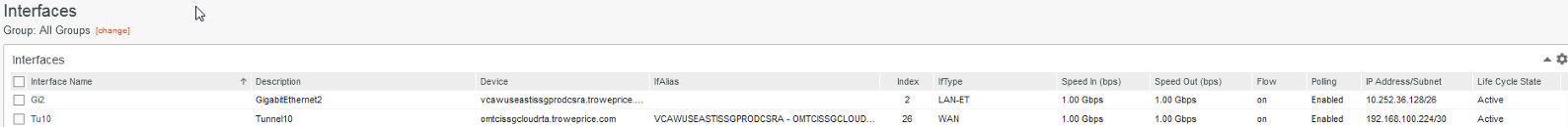

Thanks, both of you. Yes, device is in Spectrum. And I am collecting for 'tunnel' interfaces. In Spectrum, the desired interface (Tu10) is a type of 'tunnel'. In CAPM, the type (ifType) of interface is 'WAN'.
In the polled metric families for the device, under Interface, it shows 'Filtered' and 'Not Polled'.

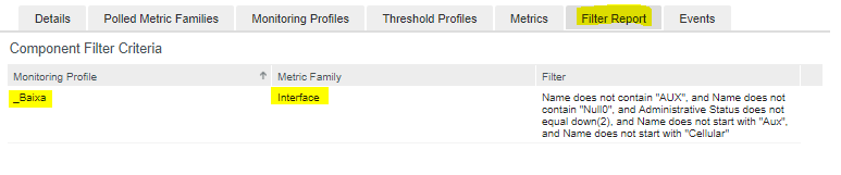

So, I try to add/update the Filter expression in the Monitoring Profile; attempting to add ifType of WAN.
It is not one of the available selections in the pulldown box.
