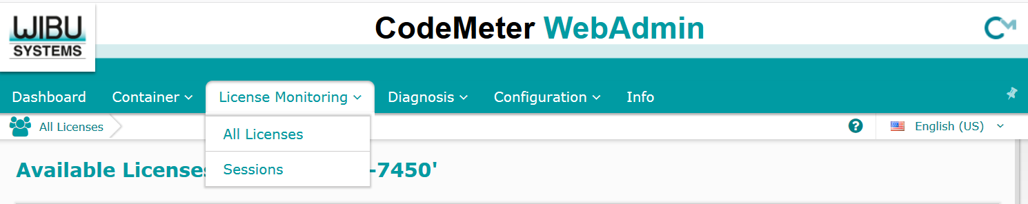

    In  Code Meter Control Center go to File Menu and  select WebAdmin  to launch the  CodeMeter WebAdmin
    Go to License Monitoring Tab and check your licenses details,
