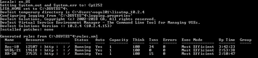

    This is the partial and initial output of the command. The remainder is likely missing, because some of the input parameter were incorrect, preventing the command to connect to the local or remote registry service.
    On my system, when I call
           VSEManager -u admin -p admin --registry tcp://<registry_server>:2010/Registry --status all
    (all default settings, registry_server is a remote system) I get
    VSEManager output
    Note: Your DevTest version 10.0.0 is about 18 months old. I recommend to upgrade to the latest release.

  • 8.  Re: Export Virtual Services from Portal
    Posted 05-03-2018 06:43 AM
    It is probably what the exceptions says: the attempt to connect to the registry service expires and VSEManager cannot connect to the DevTest Registry service: This error can have multiple reasons: Either
    • the registry_server name is wrong, or
    • the port number is false (or blocked by firewall) or
    • the Registry name ('../Registry') is different, or
    I recommend executing the command locally on the system where the Registry Service is running. Then you do not need to specify the registry server and can execute the command without it as
             VSEManager -u admin -p admin --status all
    (assuming you have not changed the default password for DevTest user admin), and get the same results as above.
  • 9.  Re: Export Virtual Services from Portal
    Posted 05-03-2018 01:54 PM
    Thank you, Ulrich.
    I ran the command in the server machine and got the details
    Thank you,
    John
