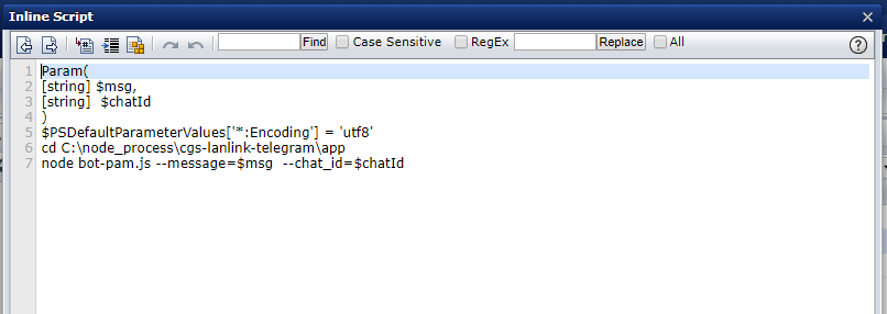

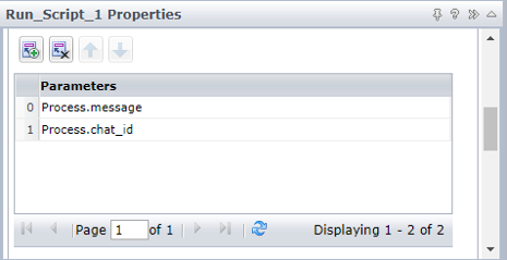

    Hi guys, I'm trying to execute a powershell script using the run script operator, the script works well, but when I pass the parameters for the powershell script, the parameters are converted to ASCII pattern.
       I am trying pass the parameter message to the script.
    The variable $msg receive the value from Process.message  and the variable $msg is  being passed by parameter to a nodejs script.

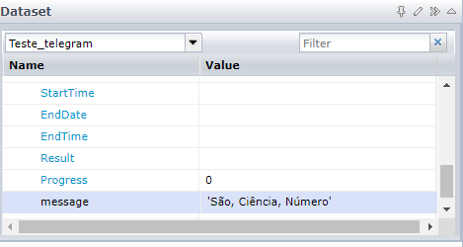

    The script works well, but if you look at dataset painel, the value of the variable "scriptOutput" is out of  utf-8 format
    anyone could help me?
    Thanks

    Posted 02-22-2019 09:33 AM
    You may need to escape the special characters or possibly use CDATA tags which should tell java and/or powershell to not convert anything about the string you are passing.
