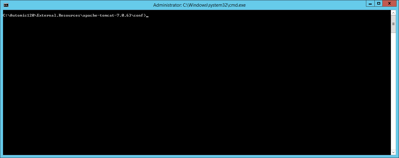

    1.     Open a cmd as Administrator and move to the tomcat config directory (TOMCAT_HOME/conf/).

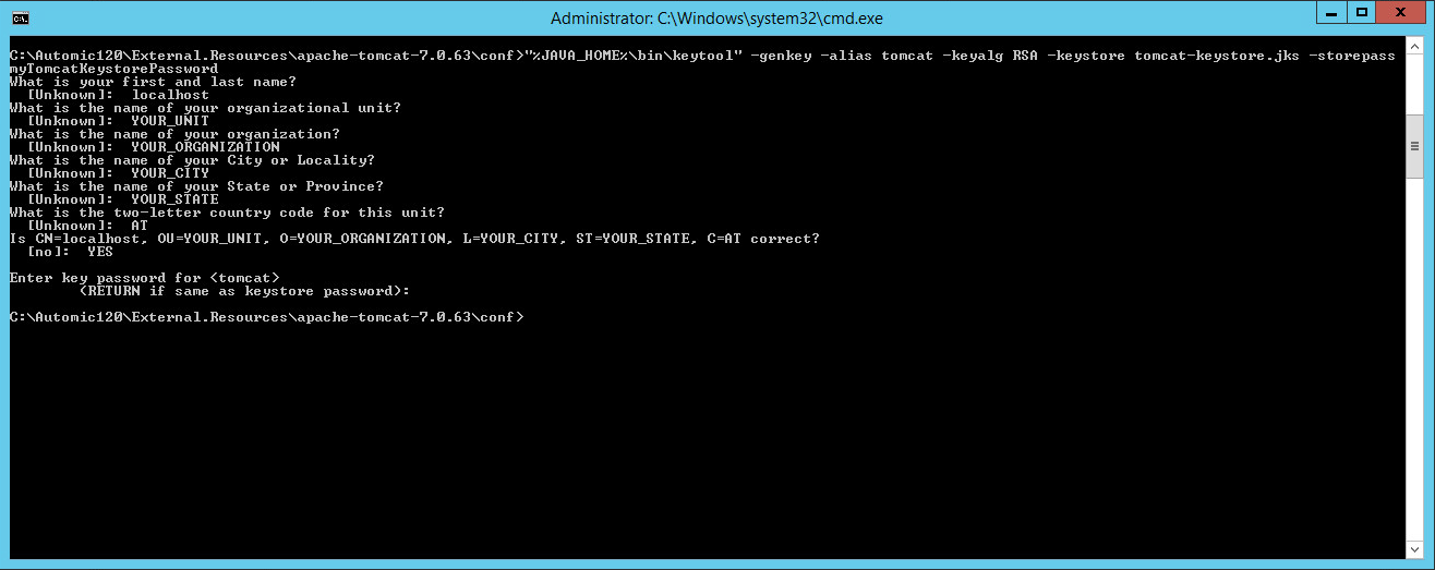

    2.     Create a keystore with a self signed certificate using the following command:
    > "%JAVA_HOME%\bin\keytool" -genkey -alias tomcat -keyalg RSA -keystore   tomcat-keystore.jks -storepass myTomcatKeystorePassword
    What is your first and last name?
      [Unknown]:  localhost
    What is the name of your organizational unit?
      [Unknown]:  YOUR_UNIT
    What is the name of your organization?
      [Unknown]:  YOUR_ORGANIZATION
    What is the name of your City or Locality?
      [Unknown]:  YOUR_CITY
    What is the name of your State or Province?
      [Unknown]:  YOUR_STATE
    What is the two-letter country code for this unit?
      [Unknown]:  AT
    Is CN=localhost, OU=YOUR_UNIT, O=YOUR_ORGANIZATION, L=YOUR_CITY,   ST=YOUR_STATE, C=AT correct?
      [no]:  YES
    Enter key password for <tomcat>
            (RETURN if same as keystore password):
    3.
    Note that you have to use the hostname / domain of your AWI instance as your first and last name, e.g.
    localhost in our example. This command will create a new keystore file named tomcat-keystore.jks protected with the password myTomcatKeystorePassword located in the configuration directory. You can change those values, i.e. the passwords as you like. The keystore contains a self-signed certificate for your AWI instance. If you do not want to used certificates signed by a certificate authority you can skip the next step.

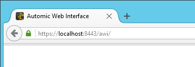

    1.     You can now access the Automic Web Interface using a secure connection by using https://YOUR_DOMAIN:8443/awi/ (e.g.https://localhost:8443/awi/)
    2.    If you are using a self-signed certificate you may receive a warning that the connection is untrusted, because is not possible to verify the identity. You can only avoid this warning if you are using signed certificates by a trusted authority. However the connection is encrypted in the same way as using a signed certificate. You have to confirm that you want to use the self-signed certificate.
    3.    You now can use AWI over https.
