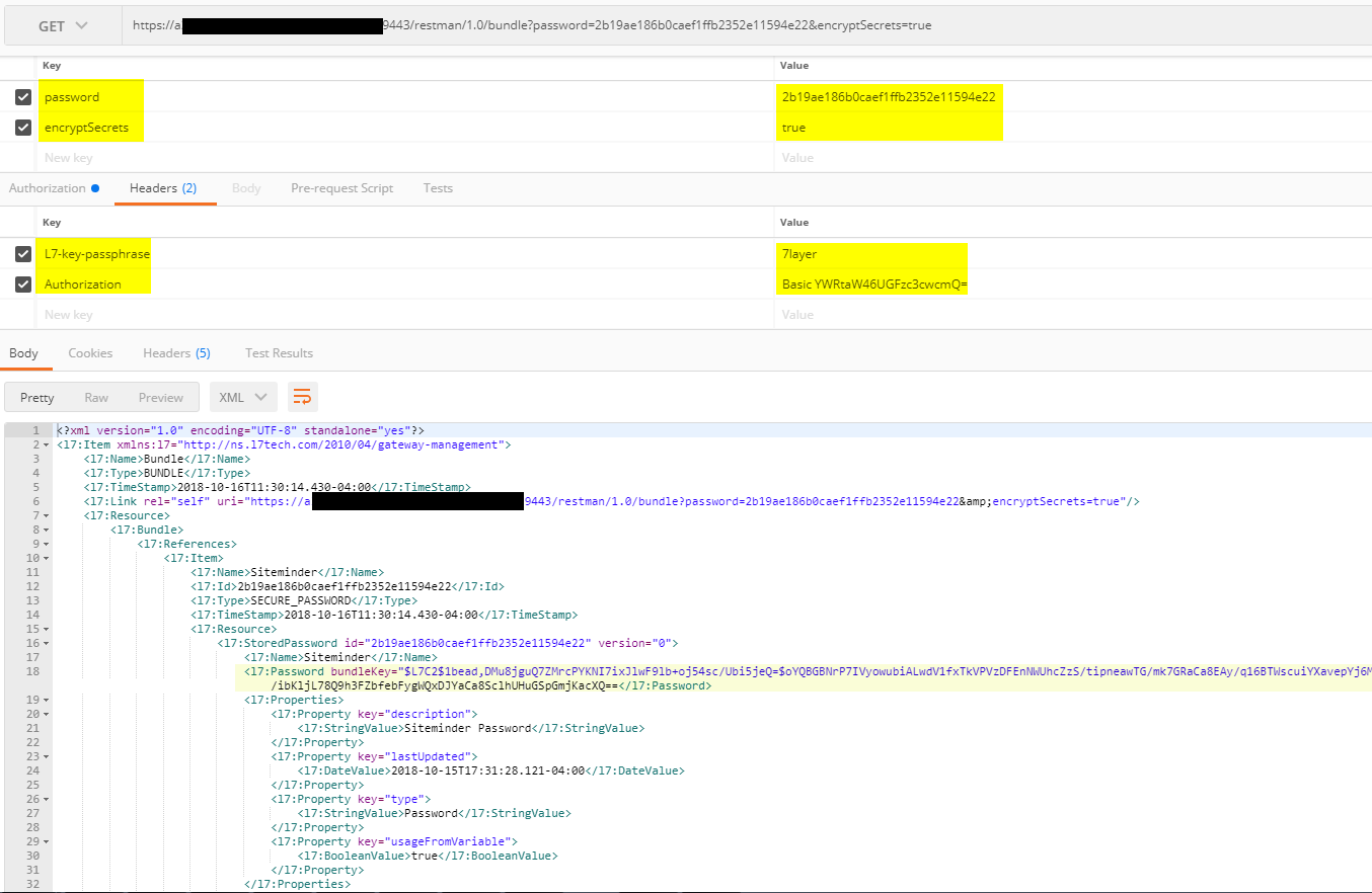

    However, when I try executing the same via POSTMAN it worked fine.
    Is this a bug in commandline GMU Tool that fails to execute the above restman command?
    Please advise? If not, then please let me know the correct GMU restman command to export the secure password bundle.

    Thanks a lot for your response.  Nope, GMU RESTMAN command includes restman in the path automatically as you can see from the output from the above commands itself. Here's the snippet of the same.
    <l7:Link rel="self" uri="https://axxxxxxxxxxxxxxxxxxx.com:8443/restman/1.0/bundle%3Fpassword"/>
    If I include restman in the path, it adds restman twice in the path as you can see from the below commands output:
    I definitely feel something is wrong/bug when this command is executed from gmu restman.
    Appreciate if you can find out more details on this command to see whether it really works.
