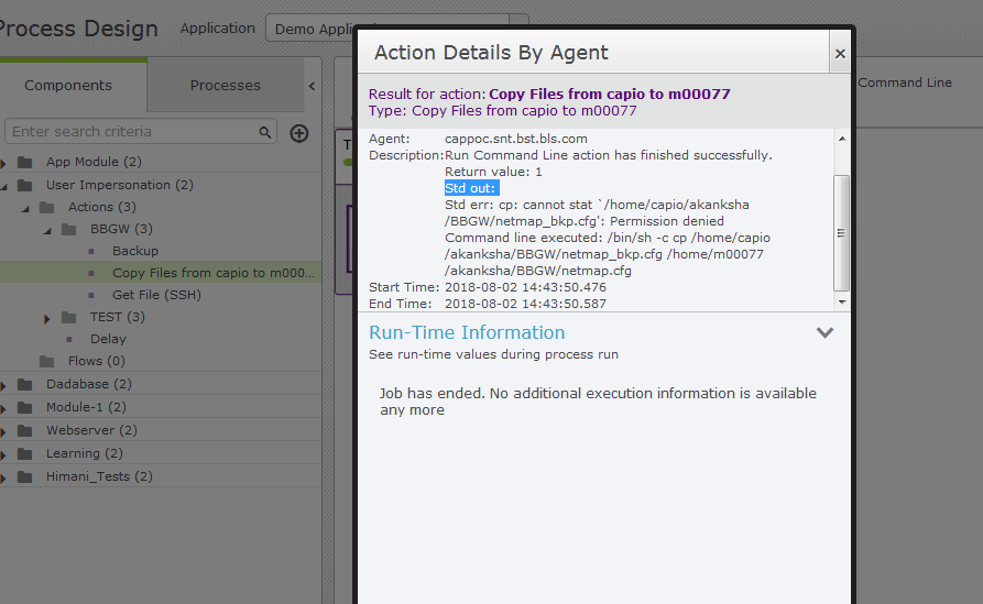

    I need assistance in a scenario where I want to perform some activities (Copy, Remove, Check file or folder exist, create Directory) in m00431 user while i am login on server with capio user. Can someone assist on this?
    After doing all the changes which is mentioned on https://docops.ca.com/ca-release-automation/6-6/en/administration/set-up-users-and-permissions, i I tried Copy activity using run command line from capio user to m00077 but the action ran successfully with permission issue (without copying files from capio to m00077). Can you help on this.

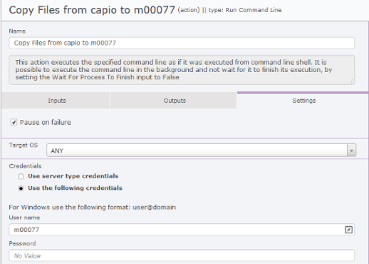

    As for the error that you're getting, could you show us:
    1. The configuration of the action (settings/properties tab for which user you're using).
    2. While logged into cappoc.snt.bst.bls.com as the user from #1, the output of the command: id

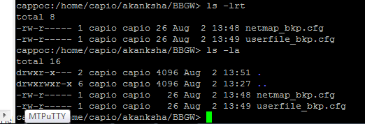

    3. An 'ls -la' output of /home/capio/akanksha/BBGW/netmap_mkp.cfg

    Posted Aug 03, 2018 09:55 AM
    Hello Gregg,
    1)The configuration of the action (settings/properties tab for which user you're using).
    2)While logged into cappoc.snt.bst.bls.com as the user from #1, the output of the command: id
    3) An 'ls -la' output of /home/capio/akanksha/BBGW/netmap_mkp.cfg
  • 7.  Re: User Impersonation
    Broadcom Employee
    Posted Aug 03, 2018 10:14 AM
    Hi,
    Based on that output it appears that m00077 might not have permissions to that file. You might want to try taking CA Release Automation out of the equation to just get things working manually first. Login to cappoc.snt.bst.bls.com as m00077. Then try to copy /home/capio/akanksha/BBGW/netmap_bkp.cfg to the directory where you want it to go. This should be done while logged in m00077 - not capio since you are configuring the action to run as m00077.

    Posted Aug 03, 2018 11:40 AM
    Hi Prashant,
    Thanks. That confirms that this is an environment problem. Please coordinate an appropriate solution with your linux admins. I could tell you run the following as capio: chmod 777 /home/capio/akanksha/BBGW/netmap_bkp.cfg

    I agreed with Gregg.
    I think m00431 user doesn't have the execution permission (+x) for /home/capio/akankaha/BBGW as parent directory.  Please check the permission without RA.

    Hi,
    I believe your problem is not application level (RA) but OS level. So, I also recommend to discuss with OS administrator.
    You can check the permission using command "ls -alF".
    In my example, I want to copy a file from /opt/test/src/a.txt to /opt/test/dest as b.txt.
    The owner of /opt/test/src directory is root. In this case, the permission of src (./) directory is 644.
    Switch user from root to other user ("oracle" in following screen.).
    In this case, same error is occurred - "cannot stat".
    If the permission of src directory is changed to 755. ("chmod 755 /opt/test/src" by owner - root)
    In this case, "oracle" user tried to copy, and then another error is occurred - "cannot create regular file".
    Because the user doesn't have write permission to target directory (/opt/test/dest).
    If grant write permission to dest directory, ("chmod 777 /opt/test/dest" by owner - root.)
    You can copy the file and the owner is creator.
    I hope my case study helps you.
