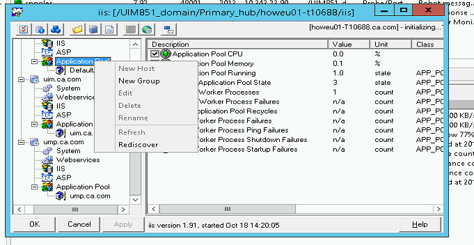

    I went back and looked at your first post I think what you are calling a SITE is an application pool under the default site.
    if that is correc then go to the application pool in the IIS probe and do a rediscovery.
    Then enable the current applicaiton pool state.

    Hi Gene, I do that and I get nothing.  Is there something else which needs to be enabled in order for the probe to see this site/pool?

    So to get some data an ISAPI dll has to be added to the IIS instance.
    Support a DLL add-on for server-side monitoring of individual requested resources, and displays running and statistical data
    Also:
    Note: To monitor application pool counters, you must use perfmon probe version 1.53 or later.
    The application pools not showing look like  a permissions issues.
    Please see :
