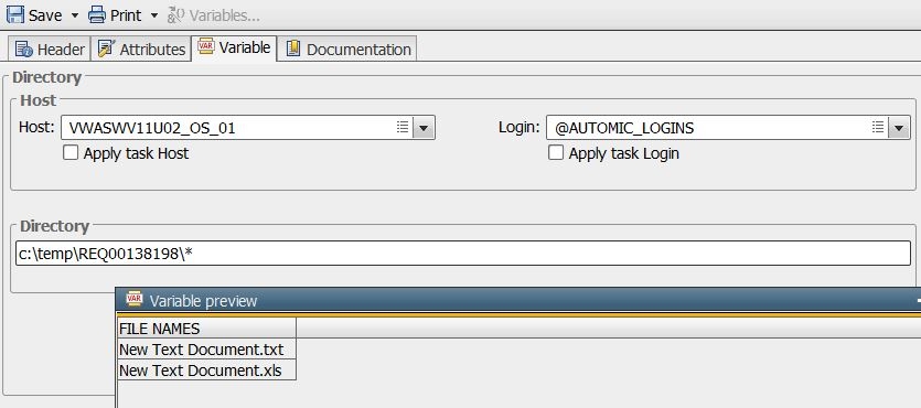

    1.  A VARA file list object grabs a list of file names from a directory:
    ksj6adxj0fqg.jpghttps://us.v-cdn.net/5019921/uploads/editor/de/ksj6adxj0fqg.jpg" width="835">

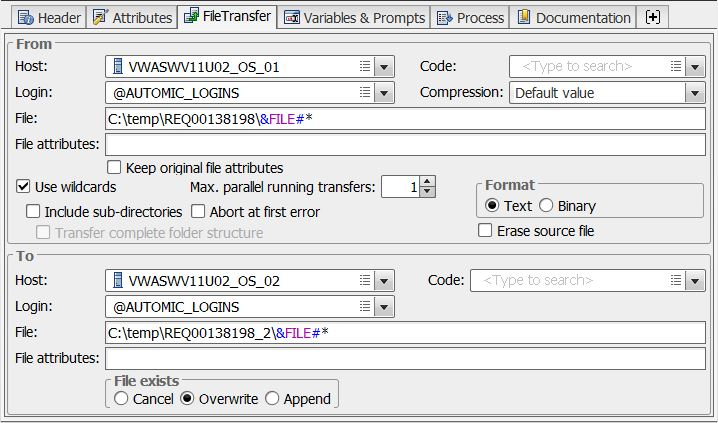

    3. In the FileTransfer tab, refer to the &FILE# variable in the file path:
