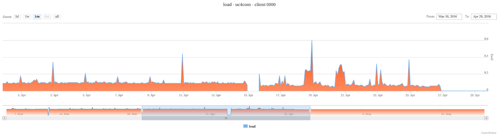

    EMI is great to create statistics or monitor the AE.
    That's just what we do with EMI: u8i56y77s0z8.pnghttps://us.v-cdn.net/5019921/uploads/editor/f4/u8i56y77s0z8.png" width="1600">

    Hi Thomas,
    Are you also monitoring stuff like Job status and Agent status? Are you integrating EMI with any Monitoring system, e.g. IBM Tivoli Monitoring, BMC Truesight or similar ?

    Posted May 31, 2016 01:27 AM
    Our agents are monitored with nagios and a java plugin for EMI. The advantage is that we can monitor the authentication too.
    For jobs we still use CALL objects.
