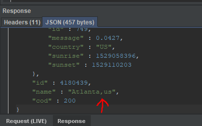

    I am trying to split an argument from request to put into the response like the next example:
    The API requires to put the next format:
    • city "," code of the country
    Like this:
    I know that using request_argument have the value
    But I want just the name of the city not the code of the country
    Is there any way to do it?
    I am usign CA Service Virtualization Community Edition.

    Adding to what deoma03 mentioned above - please check if the following expression works in your case - where q is the incoming argument name.
    {{=request_q.substring(0,request_q.indexOf(","))}}

    Sure, it was very helpful, another option is using split like this:
    • {{=request_q.split(",")[0]}}
