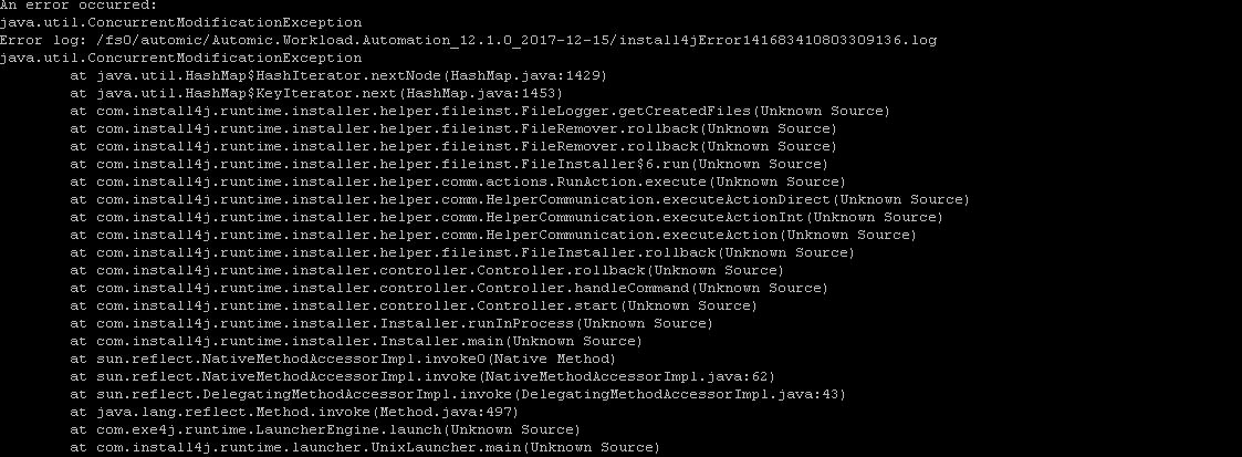

    Hi All,
    I am trying to install AE on RHEL6 using the shell script(install.sh) in Unattended mode. I have given the Var file and the installation directory as parameters but while running the script it is throwing JAVA "ConcurrentModificationException" error. The screenshot is attached regarding the same. Could anyone please tell me the root cause of this exception.
    08btapng2zgf.jpghttps://us.v-cdn.net/5019921/uploads/editor/lz/08btapng2zgf.jpg" width="1123">

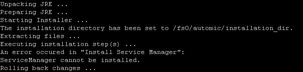

    Yes the user has all privileges to both DB and file system. I have accessed the DB using SQL plus and it worked perfect.
    One more update is that I tried to install in command line mode but again I got a different exception this time. Could you please go through the attached log file and provide us the solution. It's a blocker for us.
    dpbaux78abog.jpghttps://us.v-cdn.net/5019921/uploads/editor/7b/dpbaux78abog.jpg" width="713">

    Dear Srujan_Pathuri_9871

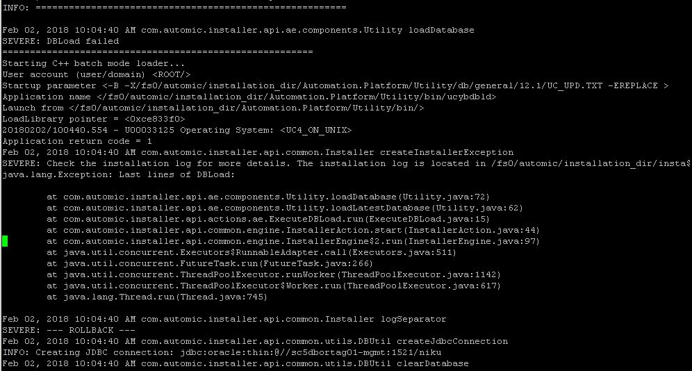

    The log show this error:
    SEVERE: Check the installation log for more details. The installation log is located in /fs0/automic/installation_dir/install.log
    java.io.IOException: Unexpected exception while copying files
    Caused by: java.nio.file.FileAlreadyExistsException: /fs0/automic/installation_dir/Automation.Platform/Utility/bin/libgcc_s.so
    It seems that the OneInstaller did not remove all files.
    Can you please make sure that there are not folders/files left from a former installation and then please try again.
    Best Regards
    Christian Glaser

    Thanks for your time. I did remove all the files in the installation directory and tried reinstalling for about three times but still I am getting the same "DB LOAD FAILED" error. I feel like I am missing out on something.  :(
    u0f8tn61n20v.jpghttps://us.v-cdn.net/5019921/uploads/editor/68/u0f8tn61n20v.jpg" width="996">

    Srujan_Pathuri_9871  have you gotten the chance to to take a look at the dbload utility logs ? Maybe there will be some more obvious errors to see?
  • 17.  Error occured while installing Automation Engine on Linux in Unattended mode
    Posted Feb 05, 2018 07:50 AM
      |   view attached
    Marcin_Uracz_10341  Thanks for the great idea.I have checked the db utility log file and it says that table or view doesn't exist?. I must tell you that I have mentioned Service ID (SID) in Automic.var file instead of db schema. So do I need to modify tnsname.ora. I'm bit confused. Please find the attached log file.

    Srujan_Pathuri_9871  It looks like you have an empty db with no table space:
    ORA-00959: tablespace 'UC4_DATA' does not exist'
    Take a look at the documentation for setting up the Oracle db.

    Yeah the db is empty. I thought the script would create everything if we give empty db. It was easy for me to install AWA in Windows, even there I have just created empty DB and it did install perfectly. I wonder why isn't the same with Linux.

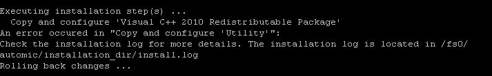

    Alexander_Trenker_120 Marcin_Uracz_10341 Christian_Glaser_7453
    I think the DB load utility issue has been fixed but then I am getting the following error while installing Service manager. Could you please go through the attached installation and db utility logs.
    gavdnpulm78x.jpghttps://us.v-cdn.net/5019921/uploads/editor/9w/gavdnpulm78x.jpg" width="603">

         Line 3511: java.io.IOException: Cannot run program "chkconfig" (in directory "/etc/init.d"): error=2, No such file or directory
         Line 3548: java.io.IOException: Cannot run program "chkconfig" (in directory "/fs0/automic/installation_dir/Automation.Platform/ServiceManager/bin"): error=2, No such file or directory

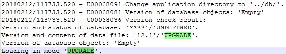

    Hi Alexander_Trenker_120 Marcin_Uracz_10341 Christian_Glaser_7453
    Need your help again. Since I have successfully installed AWA on Linux in unattended mode, I am trying to do the same in other data center and on a different Linux machine, but unfortunately I am getting error while installing "Analytics Datastore". Even though the installation setup is new, I don't understand why it is showing "UPGRADE" in the log file (attached screenshot).
    0lulwcc7y8b4.jpghttps://us.v-cdn.net/5019921/uploads/editor/j9/0lulwcc7y8b4.jpg" width="591">
    Please find the attached complete log file.

    Srujan_Pathuri_9871 , I think that the "upgrade" message is normal even during a fresh install, never took much notice of that, paid more attention to the current version / status  :)
    As for the datastore. Did you install it on the other node also ? While doing manual installs, even when I used the binaries provided in the AWA Installation package,  I needed additional postgres libraries / rpms to make it work. Maybe this is the problem?
