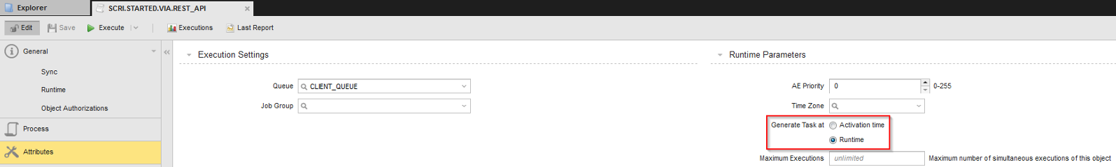

    1 - Create a simple job or script with the following attributes
    • "Generate at runtime" is enabled
    jt5xv89q4dos.pnghttps://us.v-cdn.net/5019921/uploads/editor/ff/jt5xv89q4dos.png" width="1600">

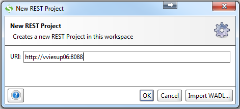

    2 - Create a new REST Project under SOAPUI
    The url must be <Automation Engine's server hostname>:<port of the JCP>
    wvi5fp9c41ub.pnghttps://us.v-cdn.net/5019921/uploads/editor/eb/wvi5fp9c41ub.png" width="471">

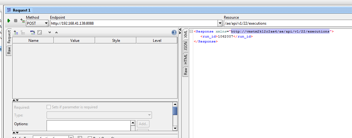

    Set the request as follows:
    • Method : POST
    • Resource : ae/api/v1/<client #>/executions
    sgham4m5i0pa.pnghttps://us.v-cdn.net/5019921/uploads/editor/bv/sgham4m5i0pa.png" width="734">

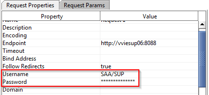

    Type in your AE user credentials in the "Request Properties"
    egu2uvlolyin.pnghttps://us.v-cdn.net/5019921/uploads/editor/1h/egu2uvlolyin.png" width="429">
    3 - Run the REST call
    Your objects should now be ready to use. Just hit the "Play" button :
    And look for the results in the JSON section:
    ozp8kwhea0j2.pnghttps://us.v-cdn.net/5019921/uploads/editor/gc/ozp8kwhea0j2.png" width="202">

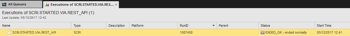

    You can see the task was activated in the Process Monitoring tab:
    4h5l8vbv261s.pnghttps://us.v-cdn.net/5019921/uploads/editor/95/4h5l8vbv261s.png" width="1160">

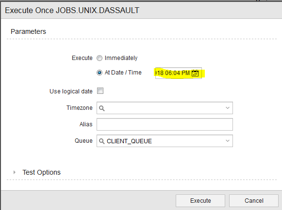

    My customer wants to be able to trigger the execution of his job at a special time. This can be achieved in One Automation via 'Execute Once'.
    qo0guwjp7yea.pnghttps://us.v-cdn.net/5019921/uploads/editor/5n/qo0guwjp7yea.png" width="581">
    How is it possible to integrate in a json API call this kind of parameters?
    Best Regards
    Pascal
