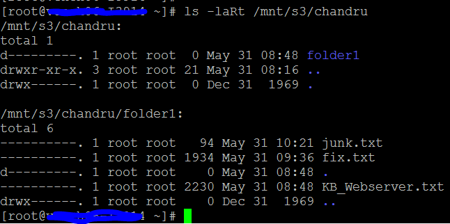

    3. Ensure the mountpoint is readable:

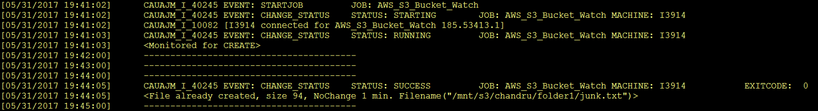

    4. Execute the job:
    You may notice that my job owner is root, its because my mount is owned by root. In realworld, you may not be able to run jobs as root user on *NIX. However, I believe tools available to mount S3 on Linux allow one to mount the filesystem as non-root user and you can manage permissions/ACLs within AWS as well. Please check with your Linux Admin on this.
    Disclaimer: S3FS was used in this example only to prove the point that FW jobs can monitor files in S3 bucket when mounted on Linux/UNIX. I am NOT recommending S3FS or similar tools. And, do NOT attempt to run job as root user on *NIX systems. The foregoing example, again, is only to prove the technical possibility. I am NOT responsible for any damage you or your business may incur while trying to follow the instructions in my response.
    Thanks,
    Chandru
