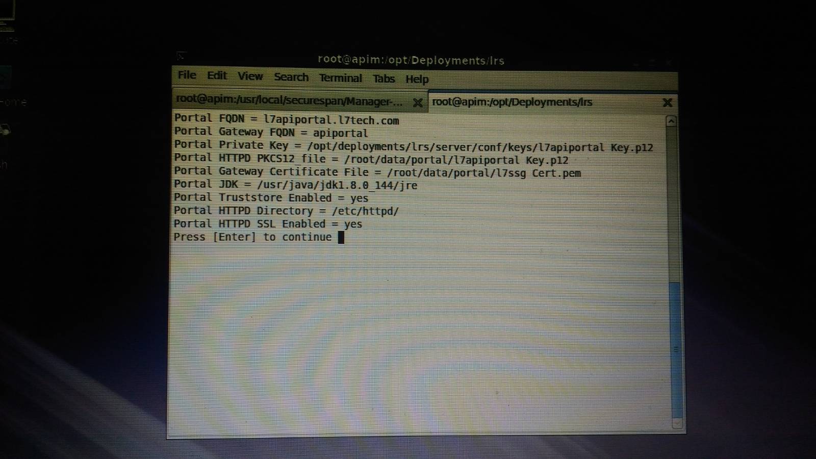

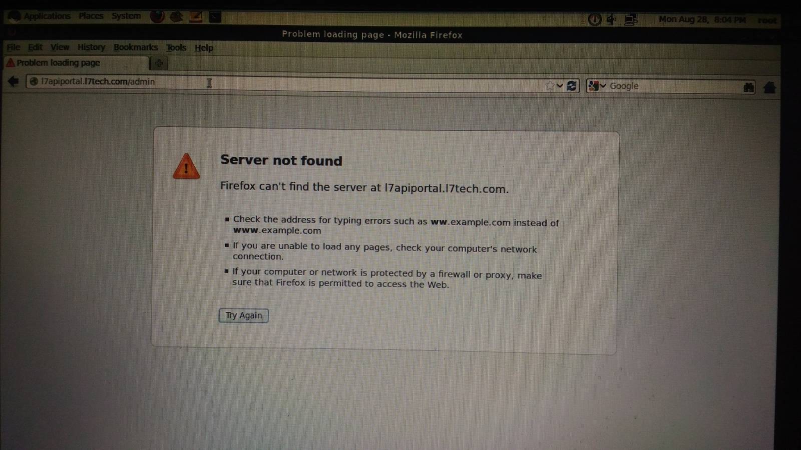

    I attached the screenshots where i faced the problem.When I running the portal this window will openThis is the configuration details of portalThis is the error I am facing.

    are you able to ping the portal hostname from your local system

    Hello Amit1995 ,
    didsi01should tell the root cause of your problem.
    You local system seems to be a redhat linux, try add ip address of portal server and portal server name in /etc/hosts file.

    Thank you Zhijun He.
    The problem is solve now..
