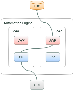

    I have found that in AE systems running on mulitple nodes, the JWP does not reliably select its SPN based on the hostname of the node where it is running.
    I have discovered that the SPN used by the JWP to identify itself to the KDC is based on the CP to which the User Interface connected. If the Automation Engine runs on more than one node, this can result in the following situation:
    1. User Interface connects to CP on uc4a
    2. CP on uc4a connects to JWP on uc4b
    3. JWP authenticates with KDC, using SPN likeUC4/uc4a.mycompany.com@MYREALMsrt9bp2gfeqv.png

    2. Even with a separate service user defined on each node, SSO may not work reliably in multi-node AE systems
    The reason, I believe, is that the JWP does not select the SPN it uses to authenticate with the KDC based on the hostname of the node where the JWP is running, but instead based on the node where the CP to which the UI connected is running.
    I’ll explain this in a bit more detail. When the User Interface   connects to the AE, it connects to a communications process (CP). Which CP the UI connects to   is somewhat unpredictable. (It depends on the order of addresses in the CP   list in the uc4config.xml file.)
    During single sign-on, the process works like this:
    2.        CP connects to JWP
    If all CPs and WPs are running on the same node, it’s simple and   will work fine every time.
    If however, if the Automation Engine processes are running on   multiple nodes, as depicted in the figure to the left, then about half of the   time, the CP will connect to a JWP running on a different node. E.g.:
    3.        JWP on uc4b tries to authenticate with KDC using an SPN like UC4/uc4a.mycompany.com@MYREALM
    I suspect that because of the above problem, SSO will not work reliably in systems with more than one AE node, even if a unique service user is defined for each AE node.
    Automic is investigating this in PRB00111313. I will update this discussion thread soon as I have news from Automic. One possible way of fixing this problem would be to force the CP connect to a JWP running on the same node. (This would mean that at least one JWP would have to be running on any node running a CP.)
