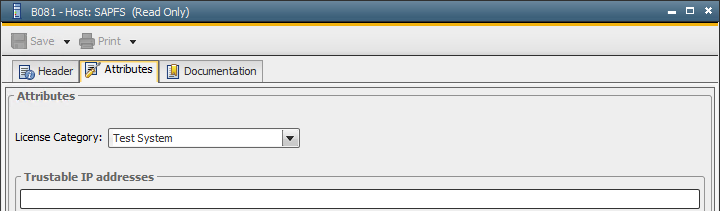

    Hello,
    In my system, in each job, I can find the notification object. If the job is failed or successful, the email is sent to specific group.
    But how about the agent itself, I edit the agent, but I don't see any notification object assigned to it?
    6qe3mop5ht64.pnghttps://us.v-cdn.net/5019921/uploads/editor/nr/6qe3mop5ht64.png" width="720">

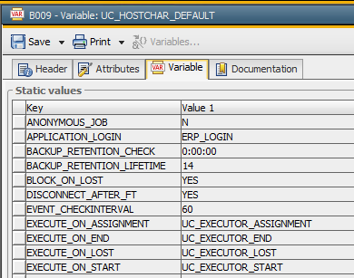

    If the agent crashes its up to you (or the admin) creating  notification via script.
    [CORRECTION]
    You can use EXECUTE_ON_END and EXECUTE_ON_LOST in UC_HOSTCHAR_DEFAULT or UC_HOSTCHAR_[AGENTNAME] to execute a notification object.

    Upps, quick correction. EXECUTE_ON Settings are set in UC_HOSTCHAR_DEFAULT or in custom UC_HOSTCHAR variables

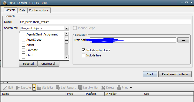

    I found it. But how can I find which notification object this command will call? I try to search these values in Search but nothing showed up.
    nrr8obgogtci.pnghttps://us.v-cdn.net/5019921/uploads/editor/9c/nrr8obgogtci.png" width="390">

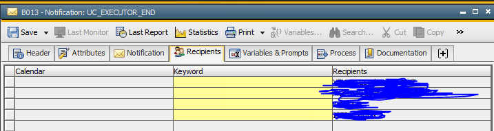

    I found the Notification object.
    jwahqeqw8vem.pnghttps://us.v-cdn.net/5019921/uploads/editor/jd/jwahqeqw8vem.png" width="717">
    When I do a "search for use", there are no results. So I guess the value "UC_EXECUTOR_START" in the UC_HOSTCHAR_DEFAULT is mentioning to this notification object UC_EXECUTOR_START because they have the same name.
    y886dq0mcilo.pnghttps://us.v-cdn.net/5019921/uploads/editor/ai/y886dq0mcilo.png" width="751">

    It works this way => everytime an agent stops or crashes the object defined in EXECUTE_ON_LOST, EXECUTE_ON_END etc. will be executed.
    You can check - if you stop one agent - the notification should be started => check via statistics of this object or message window

    Yes, I started, and it works.
