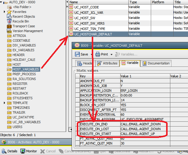

    How about using EXECUTE_ON_END, EXECUTE_ON_LOST and EXECUTE_ON_START in Client 0 instead of polling every 15 minutes?
    6pypxv8xdymp.pnghttps://us.v-cdn.net/5019921/uploads/editor/pl/6pypxv8xdymp.png" width="627">

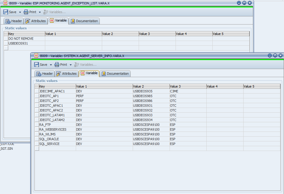

    Could you post a screenshot of the ESP.MONITORING.AGENT_EXCEPTION_LIST.VARA.X object's content?
  • 5.  Multiple PREP_PROCESS_VARs
    Posted Aug 17, 2016 10:24 AM
    I would also need a screenshot of SYSTEM.X.AGENT_SERVER_INFO.VARA.X .
    BR,
    Antoine
  • 6.  Multiple PREP_PROCESS_VARs
    Posted Aug 17, 2016 10:35 AM
    I had to create the AGENT_SERVER_INFO variable because my RA agents don't have the server names as the agent names.  I posted something else on how to find that out, but this was best I could do for now.
    hh87jblwqbg4.pnghttps://us.v-cdn.net/5019921/uploads/editor/h3/hh87jblwqbg4.png" width="948">

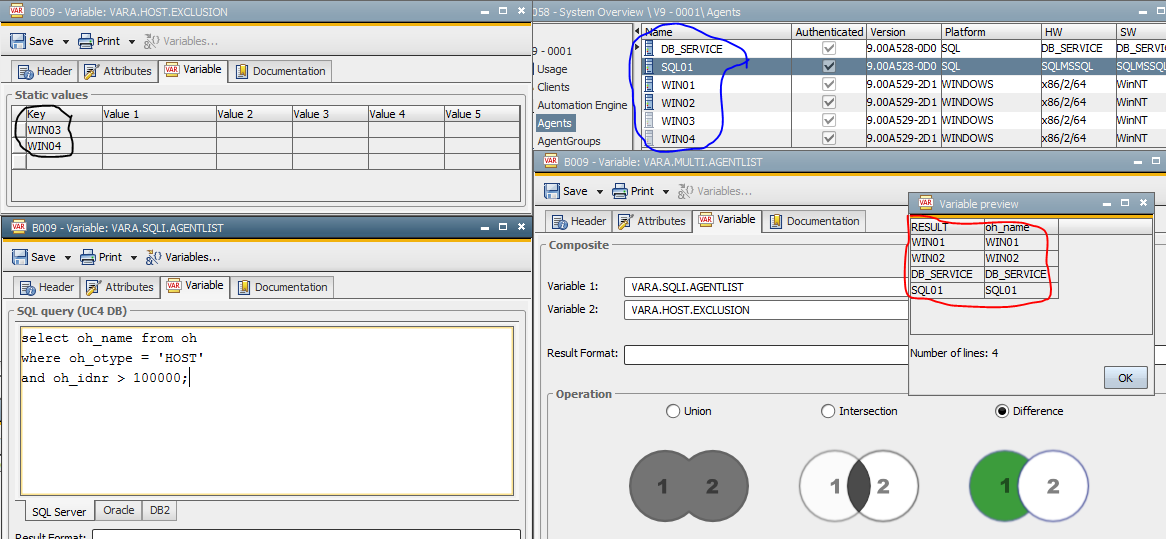

    Another suggestion - maybe easier :-)
    What about using a VARA.MULTI object for Agent exclusion?
    I did a short example, created a VARA.SQLi listing ALL defined agents ignoring limitations in HACL for other clients):
    select * from OH
    where oh_otype='HOST'
    and oh_idnr >100000
    and a static VARA containing my Agents to exclude: WIN03 and WIN04 (black circle)
    Both VARAs are source of my VARA.multi - Difference (red circle)
    here the screenshot:
    ffw99w76u6d7.pnghttps://us.v-cdn.net/5019921/uploads/editor/dg/ffw99w76u6d7.png" width="1166">
    All Agents of my Clt1 system overview in blue.
    Possibly that helps.

    FrankMuffke  - thank you SOO much!  What a wonderful idea!  I am still trying to have new functionality like this come to mind when I run into challenges like this.  Using the MULTI variable worked amazingly well.  I cut down my code considerably.
