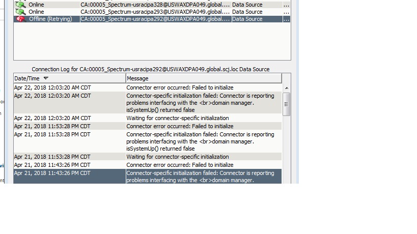

    Hi Shaheen,
    I have same question, and when i checked connector status than I got below error.
    Sun Apr 22 00:13:23 CDT 2018Connector-specific initialization failed: Connector is reporting problems interfacing with the domain manager. isSystemUp() returned false
    please suggest what mean by above error.
