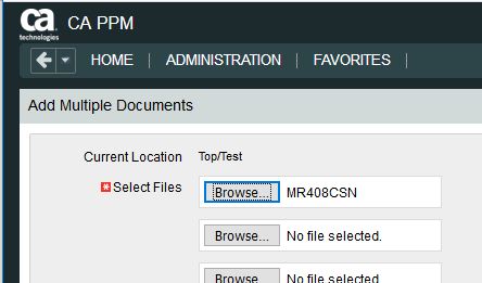

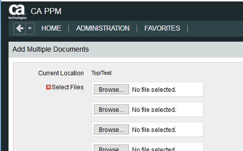

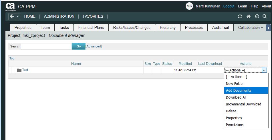

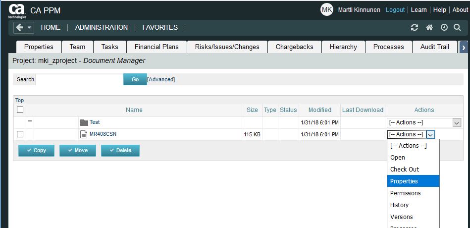

    Just add a new document

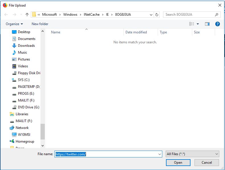

    Click Browse to add

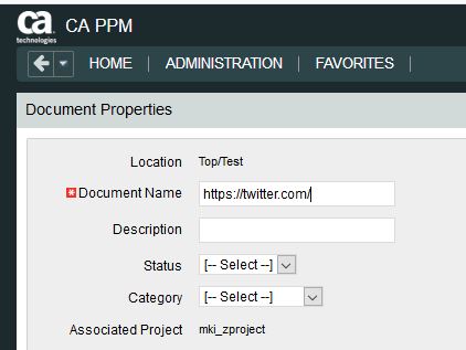

    Write the URL as the document name
    Notice that it is changed. Click Save and Return.

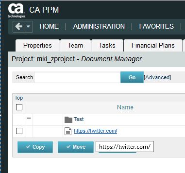

    Open Properties
    Change the name back to the URL

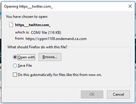

    Now it appears as a real URL. Double click it to open it
    If this is the first time you are presented with the choice to open with and do that automatically from now on. Select your browser.

    When you click OK the page opens in a new window (for me)
    Now the catch is that the link refers to something on the local drive - see the URL when the page opens or the file path when the "file" is selected (at least on my system).
    That means that the link is not likely to work for anybody else.
    Maybe somebody more technical can work around that - like putting the link on a shared drive on the server.
