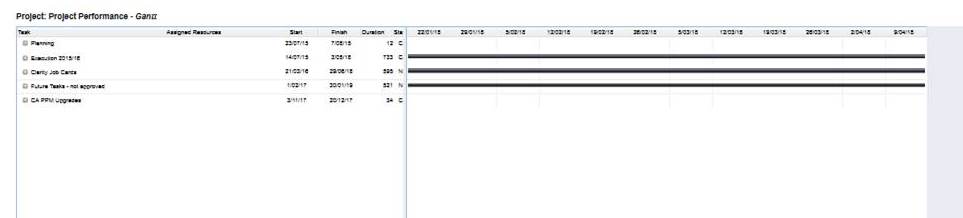

    Normally we do our Gantt chart printing using Open Workbench, but have recently started to roll out Clarity PPM to other areas which do not have OWB.  Attempted to use PPM Gantt, where there is a 'printable view' icon, but sadly the gantt bars do not show up
    Shailey from CA Support was able to find a solution.
    If using Chrome:
    Use the Printable View
    Once the new browser window opens, press Ctrl-P, and select More Settings
    Make sure ‘Background Graphics’ is ticked
    If using IE or FireFox:
    Select File / Print Preview
    Select the Page Setup from the toolbar
    Make sure ‘Print Background Colours and Images’ is ticked
