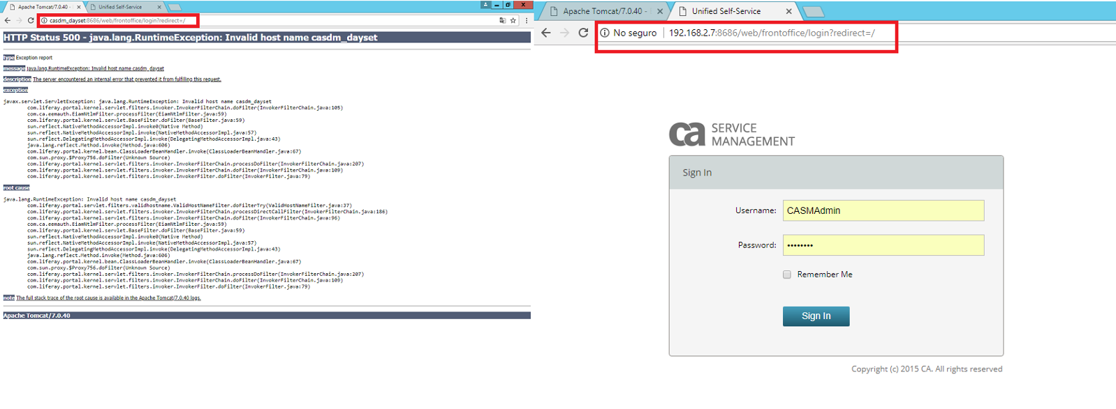

I comment you, that we are working with CA SDM and we need to update our environment, but we have a problem with USS.
USS has a problem with tomcat, but it is only with the hostname.
We can enter the USS without problem through the local ip and the publication of the tool, but when we enter by hostname, it does not work, and when we try to update, it does not show error in the connection with the server.
error
3/28 12.13.06.119 DEBUG [DeployThread: Validating Unified Self-Service Configuration] [ProgressPage] ProgressPage - Task Error. 2017/03/28 12.13.06.119 DEBUG [DeployThread: Validating Unified Self-Service Configuration] [ProgressPage] Task Error. TaskID: task.verify_osop,Validating Unified Self-Service Configuration 2017/03/28 12.13.37.804 DEBUG [DeployThread: Validating Unified Self-Service Configuration] [Task] inside initErrMap() generic. This method should be overloaded if possible 2017/03/28 12.13.38.805 DEBUG [DeployThread: Validating Unified Self-Service Configuration] [DeployThread] Deploy Thread >task.verify_osop< Message >Validating Unified Self-Service Configuration 2017/03/28 12.13.38.805 INFO [DeployThread] [DeployThread] Abort requested while running task: Validating Unified Self-Service Configuration 2017/03/28 12.13.40.611 INFO [AWT-EventQueue-0] [EmptyValidator] With in Empty Validator... 2017/03/28 12.13.40.638 INFO [AWT-EventQueue-0] [SDMConfig] Component list : 121 2017/03/28 12.13.40.639 INFO [AWT-EventQueue-0] [SDMConfig] primary<>false 2017/03/28 12.13.40.639 INFO [AWT-EventQueue-0] [SDMConfig] ServerType >> Primary
I comment you, that I performed the following tasks. -- I modified the host file and add the hostname. -- I modified the server.xml file of the path the tomcat in OSOP, and add the alias with the host name and I restart the tomcat -- I removed the cahe in the explorer and temporal files in the work folder the OSOP -- I reconfigured tha CA SDM with the IP -- I verified the ip local and DNS, and all good but the error persist.
