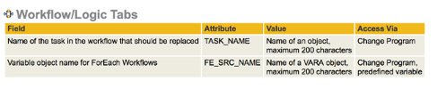

    FYI joel_wiesmann_automic  It appears this has been fixed in the v11 documentation, but still occurring in the v10 docs. I checked with Dev and the docs for v10 will be fixed in 10.0.6.
    v11:
    hpb5o1erezmu.pnghttps://us.v-cdn.net/5019921/uploads/editor/jk/hpb5o1erezmu.png" width="500">

    Based on what is in the v11 docs, I think neither (get_att or put_att) would be a way to access the attribute.
    Since the functionality isn't available currently, I would create a post under the Product Ideas section explaining the business reason for the Product Managers to review.
