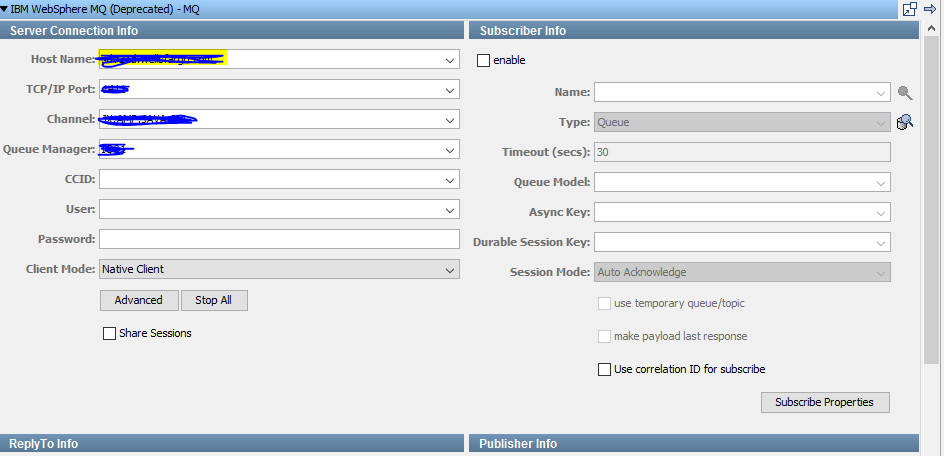

    Hi,
    I'm getting below error when I click on "test" in MQ option.
    I have entered following details in DEVTEST.

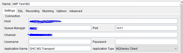

    I have copied all these details from my existing tool RIT
    Application name and Application Type field is not available in DEv Test
    Added all the required jar file in lib\shared folder . I'm using devtest 10.1
    Could you please let me know why i'm getting this error and am I missing something or entering wrong value in the field. I'm new to MQ message and exploring this option in DevTest. Please help me to fix this issue.
    Thanks!!!

    MQ 2400: MQRC_UNSUPPORTED_CIPHER_SUITE
    Did you copy the Cipher Suite name from your other application into DevTest?  You're using the old MQ step, so the cipher suite field is under Server Connection Info -> Advanced.
    Is your other application Java-based?  Could there be some other setting or environment change that you had to do there?
    There are troubleshooting steps here for your particular issue here, towards the bottom under section 4.6 and 4.6.1: IBM MQ and SSL/TLS
    The page is written for the new IBM MQ Native step, which I highly recommend you use if you're starting from scratch.  The last resort troubleshooting step, which involves installing the IBM JCE provider, requires the newer IBM MQ Native step.

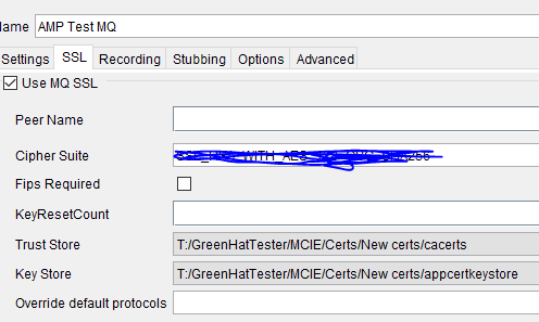

    Hi Kevin,
    I have set SSL Cipher Suite . Attached screenshot for reference. Still getting same error

    Your cipher suite is not supported by the default Oracle JCE provider.  You need to follow the instructions in this document, under section 4.6.1, to install the IBM JCE provider, and then use the new IBM MQ Native step and configure a SSL Context asset with that JCE provider.
    IBM MQ and SSL/TLS
