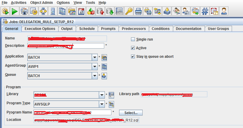

    Posted Jun 15, 2017 08:47 AM
    Hi Jennifer,
    Can you please post an example of the setup that was done? I need to migrate a SQL job from V9 Applications Manager (which had program type = AWSQLP, and the location had the directory path of the .sql file to execute). We are migrating such jobs to ONE Automation, and I am not sure how to setup these JOBS.

    Here is an example of the job to be migrated from V9 AM to Automic ONE Automation.
    ilpc8ajpb8i1.pnghttps://us.v-cdn.net/5019921/uploads/editor/4m/ilpc8ajpb8i1.png" width="818">
