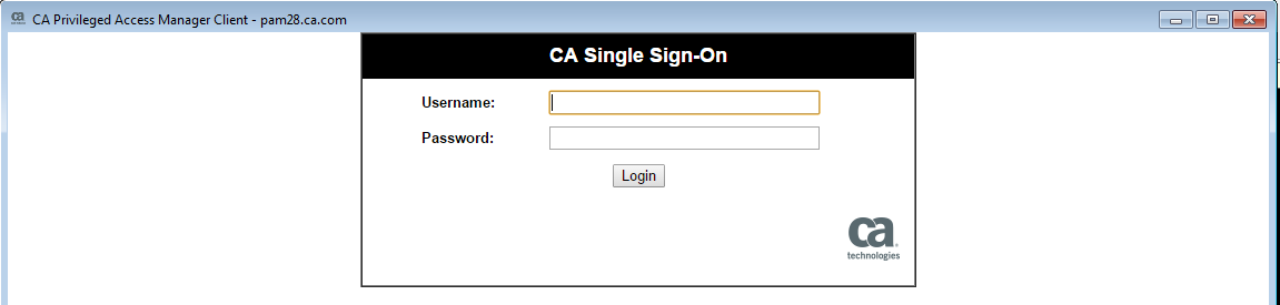

    To initiate Single Sign-On from PAM, click on the 'Single Sign-On' button when you get the PAM login prompt:
    Java Applet will launch and you will be prompt to login from pamlogin.fcc:

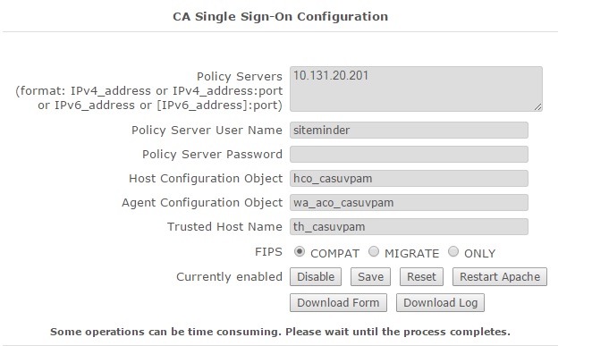

    I see the problem now. When I open my PAM Client, I actually don't see the SSO option only. Do you have any idea is I am missing some configurations?
    However in the SSO configuration I see the SSO is enabled. Bit confused why I am not able to see the SSO option. Tried uninstalling and reinstalling the client.
    I have inserted the images for your quick reference.PAM Client with no SSO Option
    PAM SSO Configurations

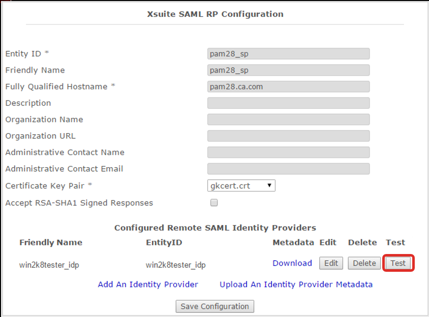

    There are two areas which CA SSO can be involved (three if you include using CA SSO as Radius Server):
    • [relate to the Single Sign-On button in login screen] Use CA SSO as identity authentication to CA PAM – which requires configuring CA PAM as RP (Config >> Xsuite SAML RP Configuration) and CA SSO as IdP
    • [the use case you have before] Use CA SSO to protect specific PAM resource – illustrated in CA PAM integration with SSO
