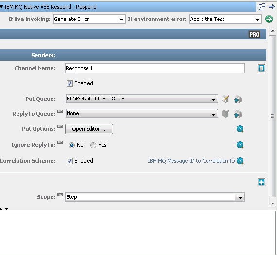

> In Respond step I don't find "Automatic" option under "ReplyTo Queue" drop down
The 'ReplyTo Queue' field on the Respond step controls the ReplyTo header field that is sent with the *response* message. 99% of the time you will not need to send a ReplyTo header in your response message.
Narasimha: VS is failing if I don't select any queue name under "Put Queue" drop down.
In Listen step I have unchecked "Asynchronous" option and in Respond step I have selected "No" for IgnoreReplyToQueue.
I have not selected any queue for "Reply To Queue" in Respond step. However it is working fine
I have selected queue for "Reply To Queue" in Respond step and this option is also working fine

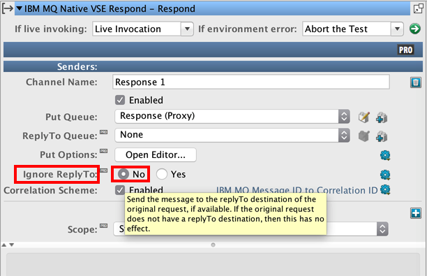

The parameter governing the behavior of ReplyTo in the Respond step is the 'Ignore ReplyTo' field, which is set to 'No' by default:
