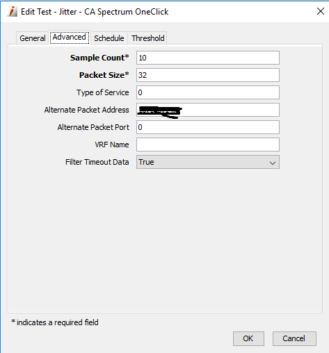

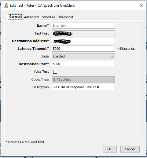

    I have ca spectrum 10.2.3.
    I have tried to config Jitter test to one of Cisco router 1949 k9 model. It has IPSLA and Jitter configured.
    after saving test the status changed Device disabled and Bad configuration.
    Please assist to create Jitter SPM test.
    SNMP community string : Read-write.

    Hi Glenn,
    Thanks for reply, I have read/write string configured.
    please let me know any additional config required
